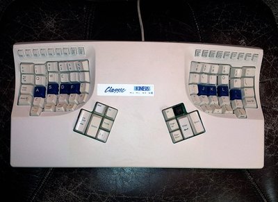

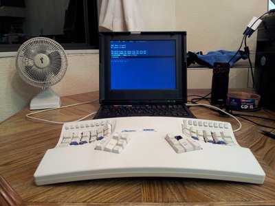

As part of my massive dumpster haul the other day, I picked up a wonderfully bizarre Kinesis Classic PS/2 keyboard...thing. It looks like this:
144.53 KiB
2251 views

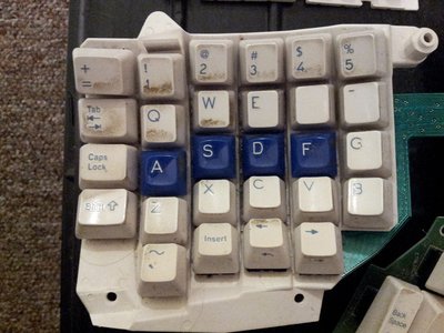

As you can see it's in a sorry state and is absolutely filthy. This is one of the most disgusting keyboards I've ever seen. I did try it, it seems to work, even if I didn't want to touch it with my hands. Yick. That said, these were quite expensive new, are fully programmable, and aside from the rubber chicklet function keys, use Cherry MX switches throughout. I posit that this thing is worth restoring. So that's what we're gonna do in this thread.
Let's see what we have to deal with...

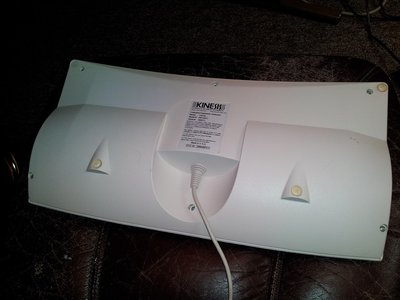

Here's the bottom. Not as bad. I left this pic full-size so you can read the stickers if you want.
181.22 KiB
2248 views

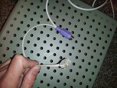

This thing is fully programmable, apparently the config file is plain text that you upload to it. It has this RJ11 jack on the cable that I'm not sure what is for.

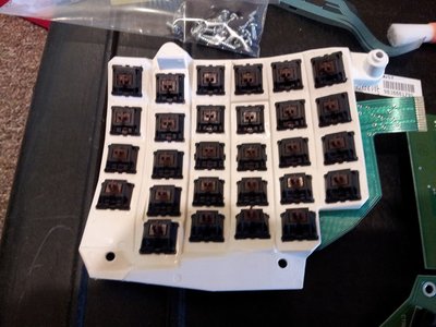

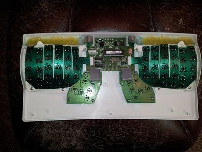

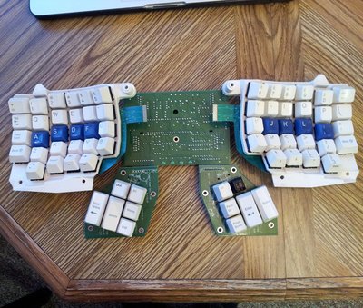

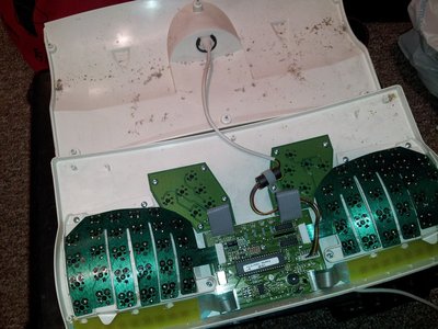

Open it up, and
203.18 KiB
2248 views
Wow, that is... strange. There are a bunch of dust bunnies, as expected, but the PCBs themselves look pretty clean on this side. The filth on the inside was dry & loose, so I hit it with the vacuum.
262.04 KiB
2248 views

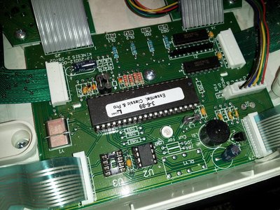

Here's a closeup of the main control board. I don't know how many of these things were made but it had to be a pretty small run. Note that the ROM is stickered for three different models (essential, classic & pro) and there are empty spaces for other components on the PCB. Also the instruction, "cut for USB." In a lot of ways it seems more like prototype hardware than a mass-produced product.
231.71 KiB
2248 views

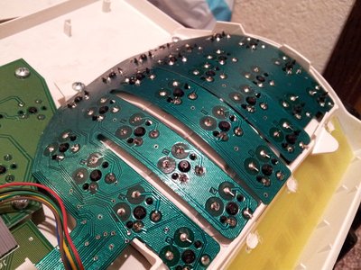

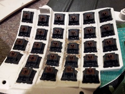

The PCBs for the keybeds are that curved and held down at least partly by hot glue. I bet EEVblog guy would have something to say about that.

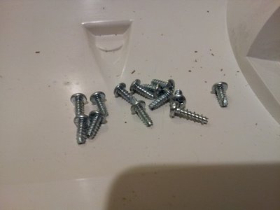

Incidentally, all the screws on the inside are identical except one. The six that hold the case together on the outside are also identical.

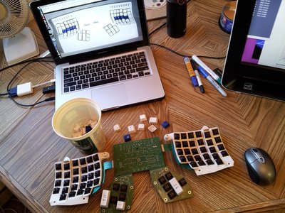

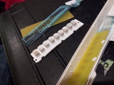

This is how the function keys are assembled. Typical membrane design which is backed by a piece of blank PCB material(!), which is plastic-welded in. I had to break the "welds" (white dots) to get them out. Not sure how I'm going to hold them back in yet.
201.22 KiB
2248 views

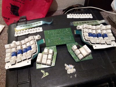

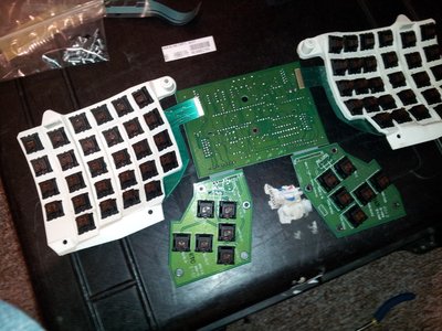

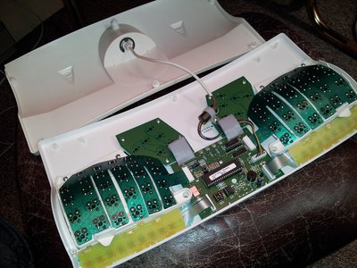

Here's what all the innards look like exploded out. Yes, they're still gross.
180.24 KiB
2248 views
183 KiB
2248 views
Close-up so you guys can see the horror.

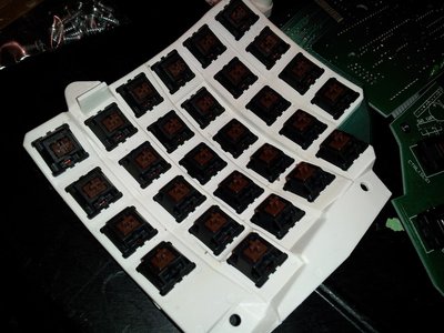

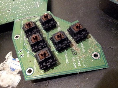

Reply 3 of 21, by xjas
150.04 KiB
2245 views
175.37 KiB
2245 views

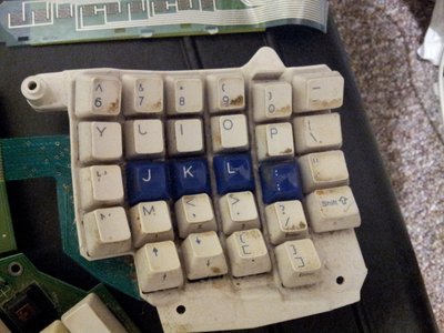

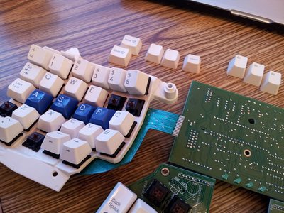

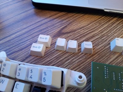

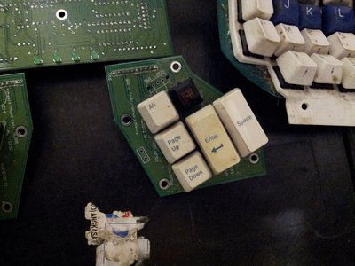

For some reason, there are three ALT keys with one missing. And no CTRLs. I don't think that was the standard layout. Some of the stock key positions are marked on the PCB itself so I'm going to have to take a closer look.
To start with, I pulled all the keycaps off and tossed them into a bucket:
141.26 KiB
2245 views
Okay, fine, I guess there's going to be some bucket.

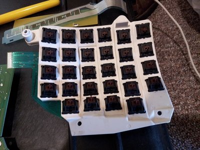

Here's what that left me with:
189.68 KiB
2245 views
205.92 KiB
2245 views
Yeah, nice. 😠

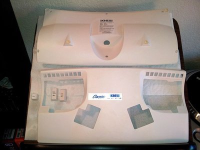

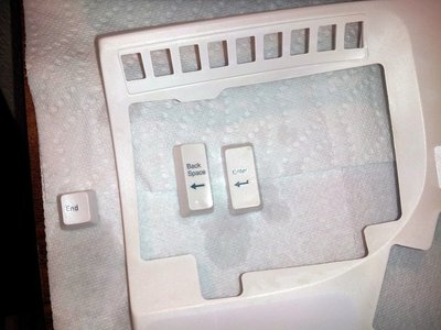

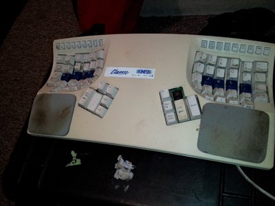

Reply 4 of 21, by xjas
224.16 KiB
2244 views

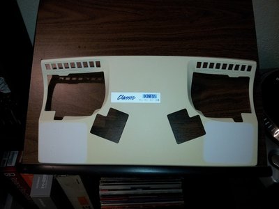

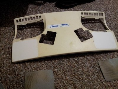

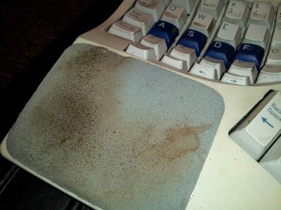

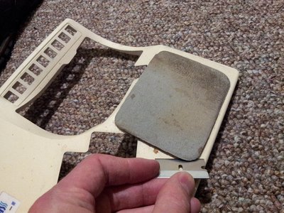

These mouse-pad palm rests are official accessories for these. Needless to say they were NOT gonna stick around. Fortunately they were easy to peel off.
199.09 KiB
2244 views
Predictably, the top cover is rather yellowed, this shows the extent. The pads went in the bin. No way am I gonna rest the same hands that I eat with on those.
114.22 KiB
2244 views
100.8 KiB
2244 views
96.94 KiB
2244 views

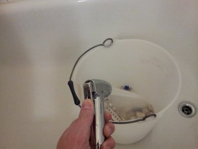

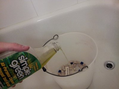

Let's make some suds!

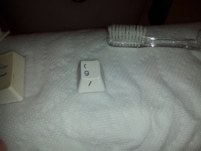

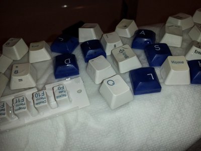

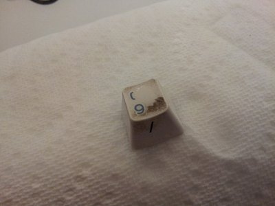

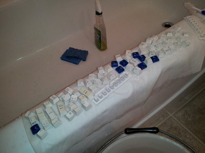

I let the keys soak in the detergent for a while, hoping that would lift away most of the grime. Changed the water a couple times and blasted them with the spray nozzle. That wasn't enough to get them completely spotless, but after all, what alternative did I have? Scrubbing them individually with a toothbrush?
104.44 KiB
2242 views
OH WAIT THAT'S EXACTLY WHAT I DID. Well, more accurately I used three toothbrushes. Every single key. Suffice to say it took BLOODY AGES and was a HUGE PAIN.
That said, the results were quite good. Here's a before and after:
104.32 KiB
2242 views
111.64 KiB
2242 views
121.45 KiB
2242 views
The blue home row keys are stock, but they're a different shape than the others. Weird.
126.24 KiB
2242 views
Laid out to dry. There are actually only 67 keys, not including the rubber F-key pads. 68 if you count the one I'm missing.

Incidentally, here's what the top cover looks like after having been scrubbed with Simple Green and dried. Yeah it's pretty yellowed, and the missing palm rests are obvious, but at least it cleaned up really well. Haven't decided if I'm going to retrobrite this yet. Only a couple of the keycaps seem to have yellowed much (the "tall" enter & backspace) so it's probably worth putting the effort on this piece.
180.5 KiB
2240 views
207.08 KiB
2240 views
I hit the keybeds with the vacuum brush and manage to clean them up fairly well. Again, the grime was thankfully not greasy or sticky at all. I'm gonna hit this with compressed air tomorrow (once the shops open so I can get another can 😜 ) which should get them up to 95%. Really glad I didn't have to clean these with liquid.

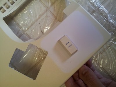

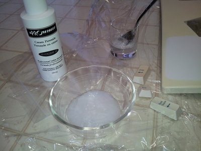

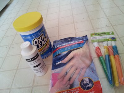

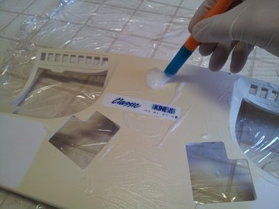

Who am I kidding, did you guys really think I'd pass up an opportunity to make this even more complicated & involved?
173.15 KiB
2144 views

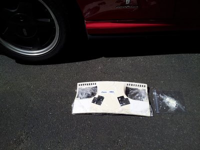

Here's about ten bucks of retrobrite ingredients from my local pharmacy/everything shop. Went for a gel peroxide solution instead of liquid. The stupid oxi detergent was the most expensive part, because I had to get it at the supermarket and they only want to sell stuff to families of 12.
133.51 KiB
2144 views
I decided to do the three most yellowed keys along with the top cover just to see how they'd turn out.
146.78 KiB
2144 views
Mixed it up in hopefully the right proportions...
134.06 KiB
2144 views
Some proper artistry going on here. Well, maybe not.
178.23 KiB
2144 views
I went for the 8-bit Guy's method of wrapping it in plastic. It's 12 PM and it's now sitting out on a bright sunny day (next to my car which gets constantly shat on by birds.) We'll check back in a few hours.

Reply 11 of 21, by xjas
WOW.
112.1 KiB
2093 views
That went well.
Just for a reminder here's how it looked like before retrobrite (but after a thorough scrubbing.) :
164.55 KiB
2093 views
Some improvement there!

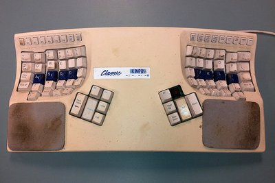

Just before I post the finished product, I'd like to remind you guys what it looked like when I started out.
144.53 KiB
2049 views
...and here it is now:
211.43 KiB
2049 views
Much, MUCH better. As soon as I find a replacement right Ctrl key I'm calling this an unqualified success.
Note that when I got it, there was a sticky note on it that said "broken." So does it work?
180.83 KiB
2049 views
Of course it works! Every key works, the internal buzzer works, all the LEDs work, the programming mode works. It's mint. That may have taken the better part of two days, but I think this one was worth saving.
