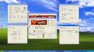

Abit BX133-raid Pentium III-S 1400 MHz

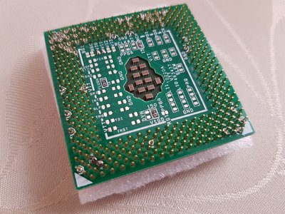

Motherboard works on 133 MHz, vcore 1.45v, PCI/FSB 1/4, AGP/FSB 2/3, modded processor Tualatin to work with Intel BX and other older chipset for Coppermine processors, modded motherboard BIOS - new bios for HPT370/372 controller now 48 bit lba, works now with hard disk greater than 128 GB. Processor temperature is about 40 degrees Celsius.
System is very stable, no problems.

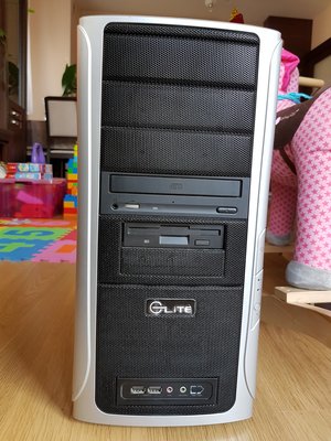

case: Cooler Master elite 331 (2 x case coolers 120 mm 1200 rpm - front and back)
power supply: Chieftec GPS-350EB-101A 350W
motherboard: Abit BX133-raid
processor: Pentium III-S 1400 MHz / 512 kb / 133 MHz SL5XL (modded)
processor cooler: Spire - WhisperRock IV (SPA04S4-2)
memory: 2 x 256 MB SDRAM PC133 CL3
video card: Leadtek WinFast A350XT (Geforce FX 5900 XT) 128 MB
hard disk: 80 GB Hitachi, 120 GB WD, 300 GB WD (all 7200 rpm)
CD-ROM: Teac 52x
sound card: Sound Blaster AWE 64 Value ISA
NIC: Realtek 8139D
fdd: Teac
monitor: Eizo FS2333-BK
keyboard: A4 Tech X-Game G800 ps/2 (gaming keyboard)
mouse: Logitech optical mouse ps/2 SBF-96
OS: Windows XP SP3, Windows 98 SE SP2.1b, MS-DOS 6.22

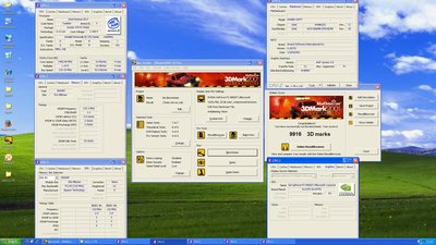

Benchmark: 3D Mark 2001 SE default settings - 9558 score

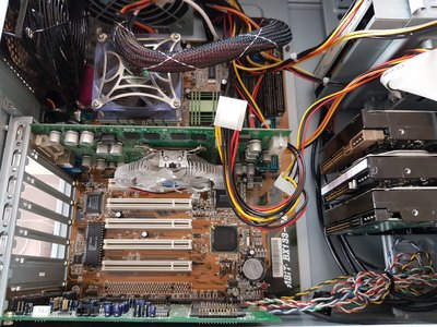

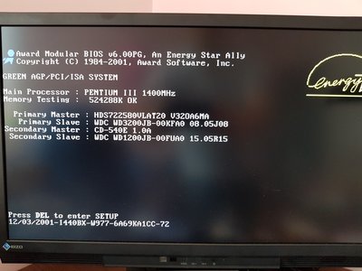

Am I the only one wandering why your hard drives and cd drive are not hooked up?
Also if your ram can take it Id ether run them at cl2 or set the FSB to 142mhz.
Nice system by the way
Reply 6 of 11, by kixs
If you take a look at the POST screen photo, you'll see that everything is connected. I guess he removed the cables for better view of the motherboard.
