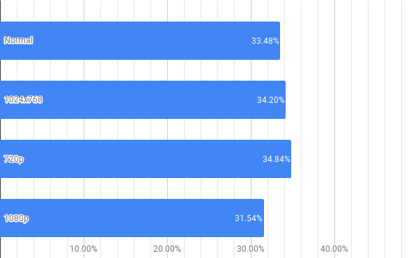

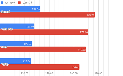

So, I did some more tests with the ASUS v9999GE (GeForce 6800). The specs of my system are the following;
2x P3-S 1400
OR840 motherboard (i840)
Audigy2 Zs
Promise SATA300 TX2 controller, 2 SSDs plugged in.
Windows XP Pro, SP3
ForceWare 93.71, settings left to default
I am using q3a 1.32c and 4 different graphical settings: q3a's "Normal" setting, 1024x768 with everything on Highest, 720p with everything on highest, and 1080p with everything on highest. For resolutions with 16:9 aspect ratio, the FOV was adjusted to mimic the default 90 of 4:3 resolutions using the info on this page.
12.41 KiB
4047 views
9.58 KiB
4047 views
The first chart shows the FPS at each resolution with/without SMP enabled, the second one quantifies the increase in FPS in each case. There's a change of only 13fps in going from 800x600 to 1080p—impressive! During the weekend I'll run similar tests with other cards and see how they behave.
EDIT: added details about my system so this is a self-contained post.
