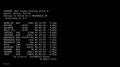

Reply 8 of 12, by superfury
After modifying the drive access commands(stuff like reading TOC and CD-ROM data) to spin up the CD-ROM, it now proceeds to read the Primary Volume Descriptor off the CD-ROM! 😁
Something strange is happening as well: when a CD-ROM is already inserted when the drivers and MSCDEX are loaded, executing a MS-DOS dir command on the CD-ROM drive hangs the system, not executing any commands(probably due to the finish phase of the seek command)?
Each time it emits a seek command, it will hang the entire operation?
Edit: It simply takes a long time(for some unknown reason) to execute the virtual seek. After that, it properly lists the root directory contents of the CD-ROM drive! 😁
