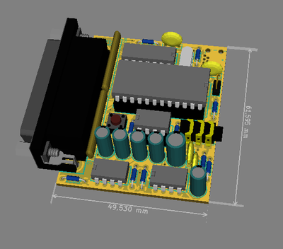

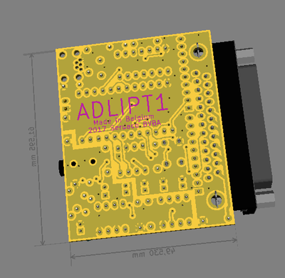

Hi !
I designed new PCB : OPL2LPT , or nickname 'ADLIPT 1' :
A compact 'adlib' on parallel port, 3.5mm line out connector.
EDIT 2021
OPL2LPT V2 now available at https://www.serdashop.com/OPL2LPT
OPL3LPT now available at https://www.serdashop.com/OPL3LPT
PCB's and components ordered for the first few prototypes,
these should be ready around 2nd week of august.
This time I took care to make it 'all through hole', so it can be a solder kit.
35.19 KiB
12959 views
32.32 KiB
12959 views
This was inspired by this project : http://www.raphnet.net/electronique/adlib/adlib_en.php
I used the same parallel port pinout mapping, so his adplug modification should work.
Any other software that could work ?
For DOS machines, the ultimate would be a small DOS TSR that captures 0x388 and 0x389 writes and outputs on the parallel port instead.

Reply 1 of 566, by Jepael
I hope you did not clone the awkward crystal oscillator circuitry for this 😀
Meanwhile, the interrupt pin of OPL could be connected to LPT interrupt pin, maybe even through a jumper so it can be removed.
I'm happy to do a schematic review if you like.
I can also try to mod some existing programs to work with this, or make a few programs to playback simple stuff like .RAW, .DRO or .IMF files.
Also what I would really love is a header for the DAC data so it can be easily digitally captured.
(and ADC for I2S/SPDIF output but that would be kind of overkill 😁 )
Maybe even a stereo SMD version with OPL3?
Reply 2 of 566, by dreamblaster
Hey,
the oscillator circuit is different, in fact I think only the pinout is the same as that project 😉
Currently connected is : 8 Data lines (pins 2-9), 1 address line (pin 1), 1 /write line (pin 16).
We can easily wire up any pin we like, for testing.
I will mail you about this, and also the schematic of my OPL3PLT.
The schematic for that is also ready, but PCB design not yet.
Other SoundChip boards in the pipeline, and maybe also an LPT streamer device with MIDI ports.

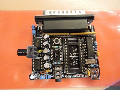

Reply 10 of 566, by dreamblaster
1st prototype... (Still waiting for the yamaha chips to arrive)
118.9 KiB
12732 views
Thanks for your support !
Reply 13 of 566, by dreamblaster
Jepael wrote:
Do you already have a player program for that?
No, I don't have software yet, will pm you. 😀

Reply 17 of 566, by 640K!enough
Did you not account for the ability to read? There is a certain amount of old AdLib code that relies on the ability to read status registers. Failing that, some software may not work, and other software may fail to detect the "card" altogether.
Did you add pull-up resistors for the control lines? From my reading, that is always recommended, but the exact value has been a matter of some debate. If initial testing fails, that may be one thing to look at.

Reply 19 of 566, by dreamblaster
640K!enough wrote:
Currently no read ability, I though any detection support could be added in the TSR.
