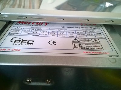

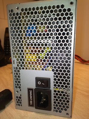

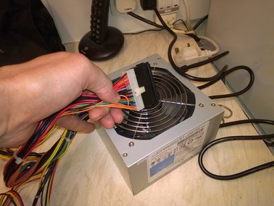

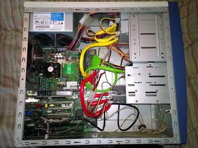

Hello cyclone3d!
I've still got a Mercury 400W PSU, which I brought brand new from Maplin Electronics in the UK back around 2005, with the required -5v rail for my ATX board with ISA slots and sound card:
459.6 KiB
2832 views
Trouble is, it's a MERCURY PSU. (SCREAM!!!)
I've done a search on eBay for other better PSUs that still use the old pre ATX 1.2 standard (where -5v first became optional, before being eliminated with the ATX 2.x standard). Unfortunately, it's 2018 so no go there. (Thus far).
So thanks for the eBay adaptor links (which are still current as of the date of this post) that'll finally enable me to use a modern ATX PSU with my old Celeron 400A ISA system, before my Mercury PSU does live up to it's bad reputation and possibly goes Darkside and kills my build.

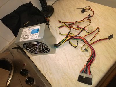

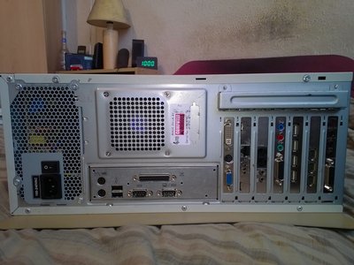

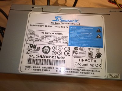

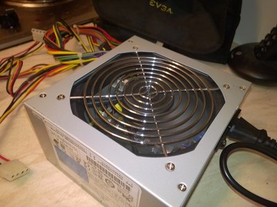

Just got this surprisingly heavy (for a 350W supply) replacement for the (possibly dodgy) 10 year or so old Mercury power supply of my Celeron 400A build:
782.05 KiB
2770 views

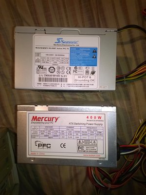

Yep. It's a Seasonic. Built like a tank.
502.63 KiB
2770 views
Should be OK though, even with just 20A on the +3.3 and +5 volt rails:
791.13 KiB
2770 views

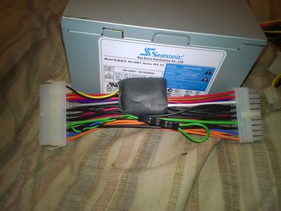

Well, it's finally time to retire the old Mercury PSU and replace it with the Seasonic...
425.48 KiB
2692 views
...because the http://www.ebay.com/itm/E24N-5VT20Y-5V-EPS-AT … A-/252903979500, with that -5V ISA power supply conversion module for my Yamaha Audician 32 ISA sound card, has finally arrived here in the UK from the USA! 😁
843.73 KiB
2692 views

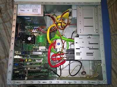

Now my Celeron 400A Mendocino build, with all the AGP, PCI and ISA things, is Seasonic powered! 😀
911.61 KiB
2692 views
You can tell it's quality when you get an "Oh. Yeah!" moment, just from the feel of toggling that Seasonic's power switch. 😉
772.32 KiB
2692 views
POSTing and booting up just fine! 😀
640.79 KiB
2692 views
Between the Seasonic PSU, and getting a replacement system HDD (a Western Digital 60GB WD600JB, to go with my Western Digital 120GB WD1200JB data HDD), I can finally do all the Windows 98se things, without my retro build croaking on me at random! Yay! 😀
