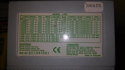

I have a second PSU (300ATX) that has:
+3.3V = 22A
+5V = 30A
-5V = 0.3A
+12V = 14A
-12V = 0.8A
+5V SB = 0.8A
It's the one which made PC turn off after about 5 minutes. I have checked the inside of it and it looks fine, so I don't know why it would turn off (as if PC lost power or was too hot). Any ideas what could be the case with this one? Is there any point in trying to fix it?

Reply 17 of 26, by SW-SSG
Caesum wrote:
I have a second PSU (300ATX) that ...
If the model number is actually LC-300ATX, it is one of those notorious Deer PSUs that you should not consider using (or repairing). Your machine powering off suddenly despite nothing apparent being wrong is one of the hallmarks of these units.
Reply 18 of 26, by Caesum
Maybe an attachement would clear this up? I dunno, maybe I'm just reading it wrong. But if this PSU is also bad, then I guess I'll try to find a replacement. Since I'm in Poland ebay is a no-go for me tbh, since costs are higher than it's worth, but I'll check allegro.pl and see if there's something useful. Do you have any suggestions which brands should I consider and which not? Or not really?

Reply 19 of 26, by Aideka
Please, kill that thing with fire before it kills itself, and your computer with it. I found a picture of the insides, although from the 250w model, and I have to say I have perhaps never seen a more pathetic looking PSU. 😢
