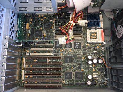

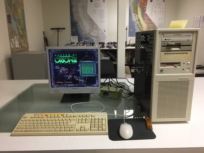

Hey guys, I have this Data General Machine that I've gotten running on Dos 6.22. May install win3.1, or possibly Win95 if it's up to the task. Currently it's set up with:
-Single Pentium 100 CPU
-112MB ram
-on board video (unknown board/chipset, apparently Intel) with 3x PCI and 6xEISA
-Soundblaster 16
-SCSI controller (not in use)
-3.5" floppy, 56x CD rom (not period, but more functional)
I'd like to beef this thing up and fully utilize the dual socket motherboard. I'm sure it would probably run win95 as is, but what's the fastest dual CPU combo that would work?
The main goal is to play old LAN games with my brother. I gave him my HP Vectra with a P-150 in it, which has 64 megs of ram, 1MB onboard video, and runs well. I just want them to be roughly comparable with one another.
By the way, this thing weighs a TON. I thought about selling it, because it's pretty big for the space I have it in, but it's just too well built and heavy to get rid of it. I couldn't find much information on these machines from Data General.
It came with SCSI tape and CDrom (Caddy) drives. I swapped in a spare IDE drive I had, and a 40 GB drive set up in 4 2-gb partitions. Cleaned up some sharpie and other blemishes and it's really clean now. Case is very well made. No HD when I got it, so it may well have come with Windows 95 for all I know?

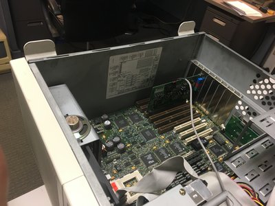

Looking at your photos, the motherboard is based on the Intel 430NX chipset, while the video is a Cirrus CL-GD5430 with an extra memory chip in the socket, for (probably) 2MB total.
As this is a Huge Expensive Workstation, it more likely shipped with some version of WinNT. Win95 might run, but will only work with one of the CPUs if you decide to install a second.

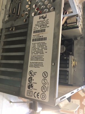

I recognise that case. It's an Intel Columbus II Server Chassis. I have one, but mine is missing the drive cage, so I'm having to waste one of the 5'25" slots for a drive mount. I would really like to get hold of that cage.
ETA: I have identified this computer. It is an Intel Altserver/CS, which is an Altserver motherboard in a Columbus case. Everything is by Intel. Data General is just the retailer. The computer I have is an Intel RC440LX Server Platform, which consists of an R440LX motherboard in a Columbus II case. The only difference between the Columbus and Columbus II cases appears to be the selection of motherboards they accept. (Similarly the Intel Columbus III, Astor and Astor II cases are all externally similar and differ only in the motherboards they can use.)

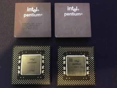

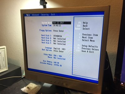

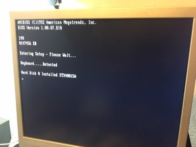

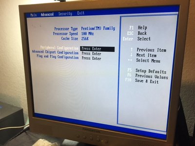

Bringing this back up because I have managed to gather a few different CPU's I'd like to try now. It came with a Pentium 100 Mhz, is an Intel MB, and AMIbios etc.
The 4 processors I have:
P-100
P-120
P-166
P-200 MMX
So far, when I start up, they all just register as 100 Mhz in the bios setup, and there are no real options in there for tweaking anything. It does boot into DOS just fine, but I can't tell if it's really limiting them to only 100 Mhz, or if that's all the bios is able to show. I realize that it's a socket5 board and these are socket 7 CPUs (other than the original P100). Anyway,
I'd like to install Win98 SE on this system, but not sure if it can handle it. On the plus side, I was able to install a Maxtor IDE card so I can run more drives, and I also added 32 MB of ram, for a total of 144.
I haven't gotten a second one of any of these CPUs yet, because I wanted to see which one would work best before I tried to utilize the dual processor option.

Hmmm, nice big pic tells me it's a 1st gen pentium chipset, the venerable Neptune, with EISA slots nonetheless, I don't know if they'd even dreamed of anything beyond a 1.5x Multiplier at this point. You're looking on the board for multiplier jumpers, no soft setup on these.
Edit: I am fairly sure your 120 will recognise the 1.5 multi and run as a P100 so that and the P100 together should work..... however, there was some problems in older dual proc systems when you used CPUs that were not the exact same core revision and stepping. Hence the former popularity of the "matched pair" of CPUs for dual systems.

I realize this thread is almost a year old, but this is the only place on the www where I found someone who has a working Altserver/CS.
I have recently acquired a motherboard that came from this system. I haven't powered it yet as I'm not in physical possession of it right now, but to build a system with it I would need the EISA configuration utility. I have been unable to find a place to download it.
If the OP would be so kind to share the EISA configuration utility, I would be grateful.
