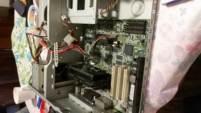

On the last Thusday I was talking with the owner of a computer parts store to see if they had an AT case or a parts computer and he told me that had 3 machines that were HP Vectras and they were stored in a closet and they were dirty as hell, so of the 3 I picked up the most complete one that came with a bonus, a 3com NIC!!
I tested it with the owner friends at the store, he configured the date for me and the original Sony battery amazingly has charge in it to keep up the date correctly x3

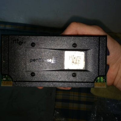

Has the original floppy and Noisegate 8.4 GB hard drive but sadly the processor was downgraded from the 450 MHz PIII to a 350 MHz SECC2 (Rare variant) PII, it had some PC133 RAM that the chipset didn't support so it took half of the RAM that was in the modules
When I took it to home it wasnt turning on or showing an image so instead of going with diagnostics and giggles I decided to spend the whole afternoon cleaning it the best I could using these stuff

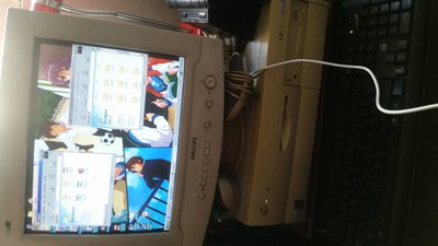

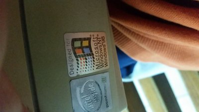

Picture I took at the subway when I was ready to take it to home, you can see that it mentions of having a PIII while in reality the original owner swapped it with a PII

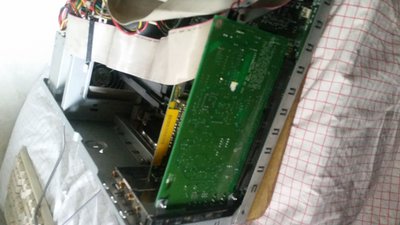

When I did took out the NIC some serious dust did fall into the slot .-.

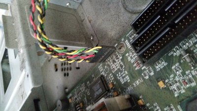

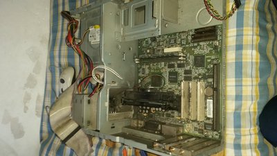

Closeup of the custom front panel connection, thanks to God that it uses standard housing so in case that the PSU blows up I can modify the replacement case's front panel connectors to adapt them to this housing :3 and also you can see the dust that this thing had
After cleaning the PSU and the board using myself as a compressor with the tube and blowing and the paint brush it became nice and clean (PSU is a 90W LiteON BTW)

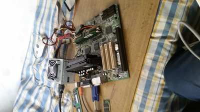

Motherboard outside of the case with the PSU hooked up and a 256 MB test module to give 128 MB for startup
It continues in the next post :3

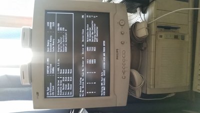

It works!! (The computer on the bottom of my monitor is my PII 400 with a Voodoo Banshee card)
The board uses standard Award BIOS and it was made by Mitac in Brazil

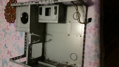

638 views
The case all cleaned up after spraying it with a garden hose and let it dry for some minutes, you can see that has some centering pegs which are cool since they let you to align the motherboard much easier, but for me it was kind of a nightmare

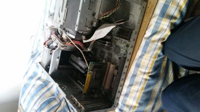

All built together with the 3com NIC that was originally in the machine

So I formatted it and installed 98SE with the appropiate drivers for the Matrox 8MB onboard video chip (Yes, the board aside of not having AGP slot at least has onboard video with his own memory) and the Crystal built-in audio that I replaced with an ISA ESS card (Made for Compaq machines) that has an internal speaker output) and I added 256 MB PC100 RAM

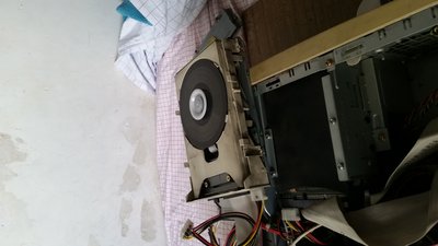

To make it better I did fix the original aftermarket CD-ROM drive that it came with
3.81 MiB
625 views
Beware while doing this, I did save the spindle from a junk drive and the belt came from a Samsung drive since I have two of them

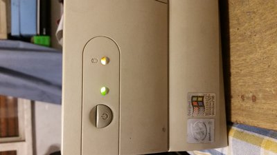

Front panel closeup

This machine finally recieved a proper PIII and now is dualbooting Spanish Win98 SE together with Jap. (日本語) Win98 SE
