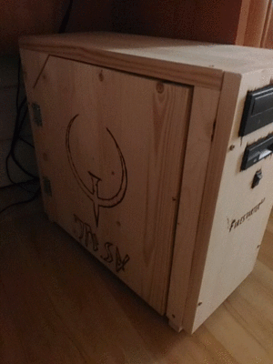

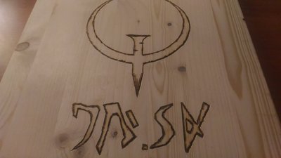

So what happens when AT cases go out of production?
You make one yourself! AND etch/burn some game graphics on it!

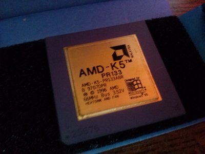

-and and anAMD K5 PR133 processor!

"BUT MUNX!", you shriek at me with the power of an overpriced Pentium, "why would you use a CPU that doesn't have a good FPU and can't run Quake well in a build with a big Quake logo?!"

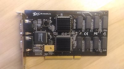

Well, that's because the 100MHz K5 won't be going at it alone! It will have 4 megabytes of dark Voodoo magic on its side!

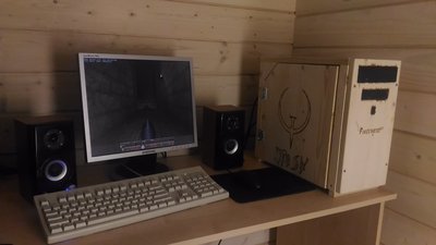

And so, in the Cozy Computer Corner we have the Case with the K5!
731.91 KiB
3268 views

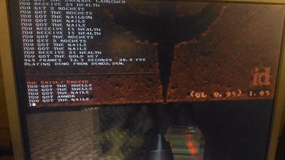

And so how does the Firestarter 2.0 run Quake? At a blazing fast, cinematic 28.2 FPS, that's how!
825.57 KiB
3268 views

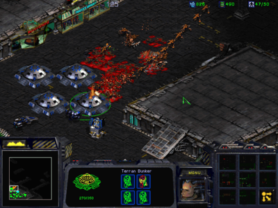

Not only that, but it easily powers through other great games like Tyrian 2000, Dune 2, Doom, and even Duke Nukem 3D @ 640x480! AND while sounding good too, thanks to the great sound and music provided by the ESS Audiodrive and Dreamblaster combo!

^^ Around 1 hour of work a day for a week. Though I'm sure I could have cut this time in half if I did proper planning.

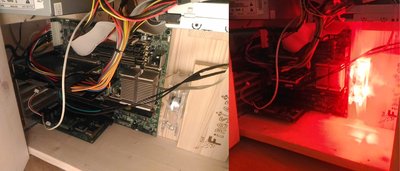

Decided to make some small changes to the build and run some basic benchmarks 😀
Time to fire it up again!
4.51 MiB
3020 views
On the visual and cooling front a red 80mm LED fan from Deepcool was added. Surprisingly silent even when powered from a molex cable. Provides steady airflow for every component that gets warm. CPU heatsink is still quite warm even with a socket A cooler. I'm doubting the 14watt TDP listed in Wikipedia.

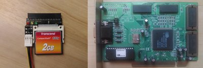

The other upgrades are:
-IDE CF adapter with a 2GB CF card that is replacing the 60GB Seagate ST360020A, which helps not only with cable management but also heat.
-2MB Cirrus Logic GD 5446BV in the place of the 4MB Virge DX. This is mostly due to Virges washed out blackness level. Surprisingly gave a nice performance boost in Duke3D - 640x480 now runs @~25fps, as opposed to ~20 on the Virge.

Quake - 28.2 FPS
Quake 2 - 11.7 FPS
Unreal - 12 FPS
Turok - 19.1 FPS
MDK performace test - 40 (P90 is shown to have 44). 273 with the 3DFX patch. Very smooth with the Voodoo as expected. Some dips in the regular Windows version, but still not too noticeable.
Other games were tested, however getting Fraps, early DirectX and vanilla W95 to cooperate is no easy task, so I can't provide numbers.
Duke3D runs ~25FPS @640x480
Screamer 2 feels very playable with the 3DFX patch (slideshow in software)
Mechwarrior 2 (original version) runs very well.
Tomb raider 3DFX is quite smooth with some dips in complex areas
Need for Speed SE is borderline playable with the highest settings
Blood is smooth @320x200 and never drops below 30FPS. Runs terrible, ~15FPS, at higher resolutions. 3DFX patch doesn't really help and makes the game look REALLY ugly
2D games like Diablo, Starcraft run super well.

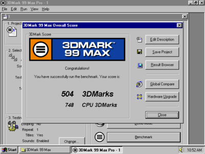

3Dmark99 does not score the poor K5 kindly...

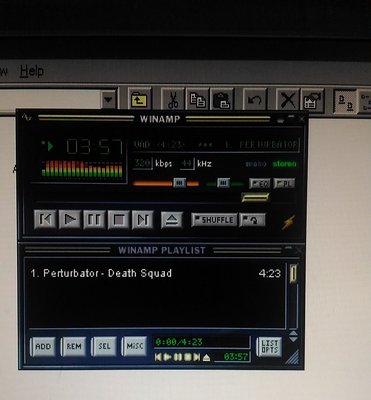

On the media side, Mpeg video is not an option, even @ 320x240. Just a slideshow with sound. Maybe this could be fixed with an upgrade to a Rage card, but I don't think media is what this PC is really for 🤣 Plays 320kbit MP3's just great though 😀

mrau wrote:
pure curiosity: how much cpu does a HQ mp3 take?
the 25 fps for duke is from dos or from windows?
Everything in this build is running under windows.
A 320kbps MP3 playback is showing ~55% CPU usage.

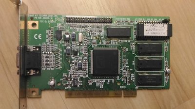

Small update time - (poorly) tested out how an ATI card from the era would compete.
ATI Mach64 VT2 vs Cirrus Logic Gd5446
622.79 KiB
2769 views
I'm not sure how I thought 25fps was the average fps for CL in Duke3D as this time I rarely saw the framerate drop below 30. In places where Cirrus Logic would get ~35FPS the Mach64 would give ~30. This very small performance decrease seems to be present in all games, be it DOS or Windows - e.g. during this final zerg push the game felt like it slowed down just a bit less on the Cirrus Logic, though all of the games are still very playable.
192.01 KiB
2769 views
One of the bigger issues I ran into was noise coming from my speakers whenever I moved the mouse. I had some sound card drivers cause this, so I don't think it's the hardware that's at fault.
There are some good sides to the Mach64 VT2. First, the image quality is WAY better. Colors are more vivid and visuals look much sharper. Secondly, it somewhat delivers on it's multimedia features. High quality MP3's show 0% processor usage! Nice to see a video card process sound 🤣
Video is a different story. I could not get any video of mine to play on ATI's dedicated video player, only the included clips, all of which are 352x240.
When played in Windows Medial Player, the CPU showed ~95% usage. These clips actually played nicely on the Cirrus Logic card too, though with 100% usage. I guess these clips are just compressed better than the crappy 320x240 ones I converted myself. Anything higher is still a slideshow, just slightly faster on the ATI card.
So a recap:
Mach64 VT2 - better image, slightly better multimedia capabilities vs slightly worse performance, worse DOS compatibility
GD5446 - better performance, better DOS compatibility vs less sharp and colorful image, no multimedia
