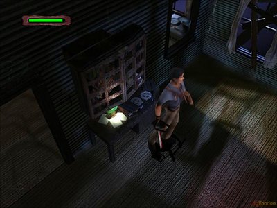

I attached the log for "Evil Dead: Hail to the King" (DirectX8). I am able to start the game and reach the 2D main menu but when I click "Start New Game", the game gets stuck (task manager says Non Responding). I have to close it through task manager. This happens natively or with dgVoodoo. Log file shows some texture format issues.
Did you try running it with anything else than dgVoodoo2? DxWnd is always a nice alternative to try to see if something really is rendering related. Because I get the same thing and it isn't rendering related, the game needs single core affinity.

The texture format errors are irrelevant (I get them too).

ZellSF, thank you so much for the single core affinity tip for Evil Dead. I did not try running the game with DxWnd.
I got Evil Dead working both natively and via dgvoodoo2 by setting single core processor affinity as you suggested. I used a bat file with the command "start /affinity 1 EvilDead.exe". Thanks again.
