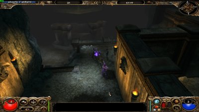

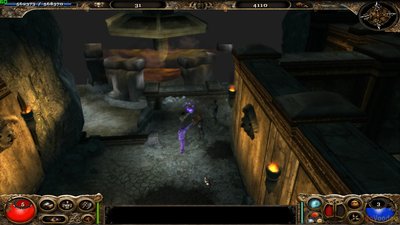

HelloI'm trying to use this wrapper alongside The Chose: Well of Souls (or "Frater", if you're from Europe). It's the only thing that helps me turn off Vsync in this game, since it's one of two games that I've ran into (the other being Dungeon Siege) that ignores Nvidia driver settings when it comes to Vsync and Triple Buffering. Trouble is that when I use this wrapper, the ingame distance fog is missing. Here are some screenshots:

Any help?

I didn't yet checked it out, but isn't it the usual z-fog/w-fog problem?
What if you try the game with the latest WIP with GeForce4 or ATI Radeon 8500 virtual card?
For those types dgVoodoo always forces w-fog.

Run the exe in the dgVoodoo2 archive. Go to the DirectX tab and there should be a dropdown there with different graphic cards. I've already tried them though, but it doesn't hurt for you to verify since I can't remember for sure if I had compatibility mode enabled on the game (which is very relevant, needs to be same as the dgvoodoocpl exe).

Yeah, I've tried myself. Neither the Gforce4, nor ATI setting works. Yep, the game looks good for on what it's built on! It has this issue with Vsync, however, where it locks the framerate to 30 fps when it dips below 60. One time you can play at 60 fps for a half hour, and suddenly it drops to 30 for, let's say, 30 seconds. No good for a Diablo game, especially when it causes the cursor to lag as well... That's why I want to work around it. The Ddraw wrapper helps, but introduces a lot of screen tearing. DgVoodoo solves the Vsync issue for me, keeps tearing away, but has this fog issue. It's like the game REFUSES to cooperate 😉
