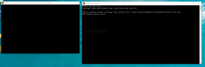

HELP!!! When I first loaded DoxBox on my Windows 10 computer it worked perfectly. Within 2 weeks, when I would bring it up it would load but without a z prompt. I uninstalled it and reinstalled it from the original compressed file I had used the first time. Still no z prompt. I uninstalled it again, went back online and d/l'ed another copy. When I unzipped it and reinstalled it, the SAME thing happened. No z prompt. I do not know what to do now. What do you suggest?

Reply 12 of 29, by Harve White
Thanks for trying to help me. Hopefully you can figure out why no z prompt appears.
    183.31 KiB
    2783 views
    This shows the 2 screens that appear when I try to load DOSBox with no z prompt. It's a .png file.
Reply 13 of 29, by Dominus
Rank DOSBox Moderator
DOSBox Moderator
Oh, you have nothing there. I‘d suggest edit the config and try different output settings.

Reply 14 of 29, by Harve White
Great. Are you talking about the DOSbox 0.74 Option.bat file? Please give me some sample output settings I can try. Please give them to me exactly so I can copy them as they should be to do the job. Is there another program that would do the same job (can be used to play dos games)? My wife is disappointed that she can't play the games she enjoy, especially since she was able to before without a problem. Would an older version of DOSBox be a solution?
Reply 15 of 29, by Dominus
DOSBox Moderator
The issue is Windows, and the solution is to edit the config file, best through the startmenu shortcut.
When you read the config, all the options for output are listed

Reply 18 of 29, by Dominus
DOSBox Moderator
Harve White wrote:
You say to edit the config file. Which config file to I edit? Thanks.
The one that is mentioned in the screenshot you posted.

Reply 19 of 29, by collector
Open C:\Users\harve\AppData\Local\DOSBox\dosbox-0.74.conf in Notepad. Under the [sdl] section look for output= and try other valid values, surface , overlay , opengl , openglnb or ddraw.
