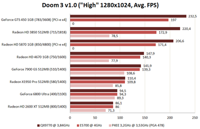

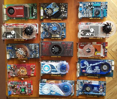

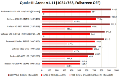

Actually there is a board which supports Phenom II x4, BUT it doesn't like anything newer than XP (nForce 3 FTW 😀).
As for GPU... I used with it most of the ones worth mentioning :
27.62 KiB
601 views
25.74 KiB
601 views

Because what is the point of having all this hardware than to test it 😉
966.04 KiB
597 views
^Out of all that hardware, the most problems I had with Radeon 8500 (top right corner) [old 3DMarks coudn't complete some tests, otherwise - GPU worked fine].
