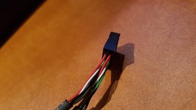

Not sure if I can explain this properly. A motherboard that I have only used with dos has 9 pin connector for usb and I use backplate for one the expansion slot that has 2 usb ports but the cable from ports only has connection to 8 of the pins. I enable the usb port in bios and I enable usb keyboard support in bios too. It seems an usb keyboard is working, but there is just weird stuff happening like I lose suddenly a display signal while I hear from sounds that game that I am playing is still running. Sometimes there is also strange interference on the screen. Then I switch back to an old keyboard with old big AT connector and I have been running it for 2 hours without noticing anything like that happening. I also have another similar usb backplate with 2 ports, but it has one pin blocked and it is on opposite site as where one of the pins is missing on motherboard so I can't use it.
If you look at here http://pinoutguide.com/Motherboard/usb_2_1_he … er_pinout.shtml you can see a pinout for standard header. 0n my motherboard there is just pins 1-9 and in the connector there and only wires for pins 1-8. Could that be causing the problems or is there something else going on?

Reply 3 of 8, by Baoran
Motherboard manual is bit strange. It only says pin numbers and they are different than in that pin out guide.
it just says
1 5
2 6
3 7
4 8
- 9
So there are 4 pins in first row and 5 pins in second.
There is also a picture of a connector with wire colors. Wires to pins 1 and 5 are red, wires to 2 and 6 are white, wires to 3 and 7 are green and wires to 4, 8 and 9 are black.
Here is a picture of the connector that I used:
2.01 MiB
1588 views
Because the empty holes are next to the red wires, I left the empty holes hanging outside the header of the motherboard to make sure red wires were in pins 1 and 5.
Reply 4 of 8, by meljor
Dersammler said:
5V - 5V
D- - D-
D+ - D+
GND - GND
See how this fits the connector on your picture? The 5v - 5v are the reds.....
Normally that would be pin 1 and 5 on your board. But since there are variations with different layouts you have to doublecheck wat +, - and D+ anD- is.
And forget about number 9.
I hope you understand that the header is for 2 usb ports? So one usb port is 5v, ground, 1x Data + and 1x Data -
Reply 6 of 8, by derSammler
Your cable fits the first pinout. Whether or not that fits the motherboard is hard to tell. One port would always work, as pins 1 to 4 are the same in both variations. Have you tried both ports? If the keyboard works on both, everything is fine.
