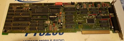

I found this Juko graphics card in my collection:
1.48 MiB
1649 views
Juko Auto G7-B
I found the jumper settings of a similar one here: http://arvutimuuseum.ee/th99/v/I-L/50442.htm
Unfortunately, this one is not the same as my card (mine also has a couple of switches at the top (9 in total) that I have no idea what their function is).
Does someone perhaps have the manual or jumper settings for this particular model?

Reply 2 of 14, by kdr
jesolo wrote on 2020-08-07, 19:52:
Just a follow up - I managed to track down the manual for this card.
Attached to this post
Thanks for posting the manual for this card!
I just found one of these in a recently-acquired "Logi 88-XT".
Did you ever find the driver diskette for this card? I'm interested in the ability to switch between the MDA mode and CGA emulation [16 shades of grey, such wow!]. Sadly the graphics chipset on this card is one of those weird "UDL" ones which have zero information available.
Reply 3 of 14, by Cyberdyne
It has RTC and WINCHESTER, IO ports and VIDEO, but no FLOPPY if i understand it correctly? COM2 UART socket is emty?

Reply 6 of 14, by kdr
Cyberdyne wrote on 2020-09-23, 08:06:
Floppy connector is the 34-pin header at the extreme end of the card.
My card also has an empty spot for the second UART chip.
I'm excited to try the CGA emulation (using the jumpers to 'force' that mode) and see how it looks on my MDA monitors. And check how accurate it is: what will 8088 MPH do to the poor thing?
Reply 7 of 14, by Cyberdyne
CN10 and CN9 are winchester data connectors, and this means that this ONLY 34pin header IS winchester control port, and not floppy port. Because if there were 2 34pin connectors, then yes you have winchester ST506/ST412 connector, and a floppy connector. they both have the same pin count, but not the same pinout.
Just saying, that be careful inserting a floppy there.
Reply 9 of 14, by Cyberdyne
OK. Then they are with some kind of strange pinout. Because usually com ports are only 9 pin connector. like that MOUSE connector in the right upper corner.
Reply 10 of 14, by dpl
I realize I'm very late to the party but.... I was just looking for more information on this particular card (as I own one in my old XT) and I happen to have the original system disk (which even has a graphical demo or slideshows on it, which I remember from 30 years ago). If anyone here is still interested, I'd be happy to share it.
From this I also remember that this weird but interesting I/O controller also has a joystick port.

Reply 14 of 14, by dpl
Hi, I managed to track down the 5,25" floppy disk (1987/1988) backup a bit sooner than I had expected...
So here it is, the G7 Utility Program (v4.2) disk that came with the computer.
I'm not sure how it'll run on faster computers but I remember the (graphic) demo ran nicely on XT in 4.77/10 MHz mode, explaining many of the features and settings this card has to offer.
From the G7-READ.ME file:
G7 MONOCHORME GRAPHICS DRIVER includes the following programs: […]
G7-NEWS - Information from other G7 users. Share their information
may help you to use your G7 more effectively.
GWFIX.EXE - Program to fix error in CORONA basic ver 1.4
G7 DEMONSTRATION SET includes :
DEMO.BAT - Type "DEMO" at DOS prompt to run a demonstration of G7.
DEMO - Directory that contains all the necessary programs for demo.
(Note that to run DEMO program, not less than 512K RAM is
necessary.)
Note :
1) For the users using composite color or composite monochrome display mode:
Composite Color mode --- it is recommended to use 40 col x 25 row
in text mode.
Composite Monochrome mode --- In the user's manual, DIP switch in XT mother
board is set to 40 col. x 25 row in text mode.
However, you can select 80 col. x 25 row by
setting position 5 ON and 6 OFF.
2) Since you have obtained the latest version of G7, the G7.COM, G7.SYS
and G7INSTALL.BAT are no longer needed. You can ignore the note to
monochrome graphics mode users in the G7 User's Operation Manual if
it has.
