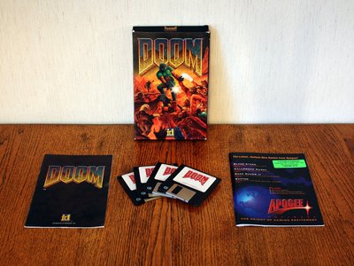

So you want older games stored and played on removable media that isn't modern. The approach here is anachronistic. You're in the wrong era for this with these games. Doom is from when software was archived across multiple disks (or CD) and installed to a hard drive. The hard drive was part of the requirements when they advertised the software. They weren't quite like console cartridge games then. Games played directly off of the floppy are from when computers had two 5.25" drives and no hard drive or a 10MB drive (1980s). Some early 90's games were like this as well on 3.5" or could go either way. But hard drives were so much faster that you always copied it over when you had the space.
CDs are 15 cents and they won't protest empty space. The floppy disk formats being discussed here are extinct and extremely rare. Games were not distributed commercially on ZIP or JAZ or 120MB or anything else. Those formats were for home document backups before CD burners became affordable and before people had cloud, home networks, wifi, and NAS in their homes. So 1.44MB is practically all there is for disks.
Of course it's all just data and you're free to do whatever you want and buy more stuff. One thing though is the read speed off of these drives may bottleneck the game's performance. Also your OS may not have a driver for the drive or its interface. There wasn't so much USB for these things back then. You're looking at SCSI, IDE, or Parallel. Newer PCs today don't have any of those interfaces so you will need an adapter.
