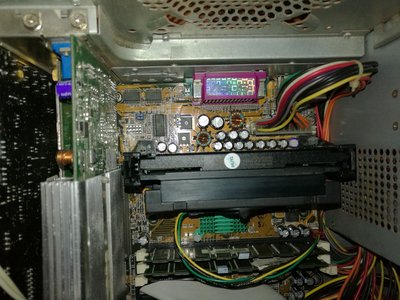

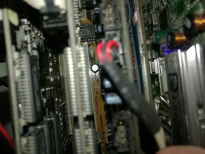

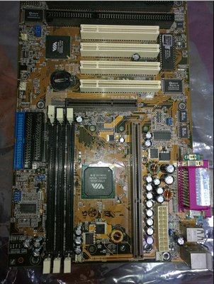

I've thought of that possibility but I'm a complete noob at identifying blown caps; a random clue led me to search for visually blown ones (which I'm not sure if it's the right thing to do), but I'm still at a loss:

Reply 3 of 5, by jesolo
I agree with derSammler.
The cause is most likely due to bad caps but, it can also relate to bad memory.
You could first try to swop out the memory and see what happens (or run a memory test, either on the existing motherboard or, another one).
Unfortunately, not all bad caps can be identified through a visual inspection alone - sometimes they look fine but, have dried out over the years, resulting in the capacitor operating "outside of its specification".
In such a case, replacing all of them is your only other option.
