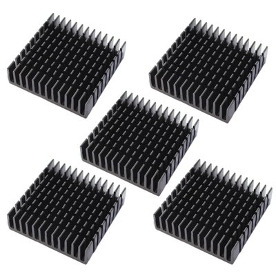

Reply 7 of 7, by cyclone3d
Ok, great. I ended up ordering 5x 40x40x11mm heatsinks from China for $2.79 total shipped.
https://www.ebay.com/itm/5pcs-40x40x11mm-LED- … es/302300250759
141.85 KiB
854 views
At that price it is not even worth me messing with modifying larger ones to fit.
I'll probably just have an 80mm fan mounted somewhere to blow in the direction of the heatsink. I really despise those little junky fans that came with the 486 heatsinks as they always seemed to die pretty quickly.
The CPUs I have are both AMD. A DX2-80 and a DX4-100.
I've also got a Kingston 5x86 133 chip, but I don't know if it works. Arrived with bent legs on the CPU package itself as well as there being corrosion in between a lot of the legs. I got a refund. I may try to straiten out the legs and clean it off but not sure I want to chance frying a board with it.
