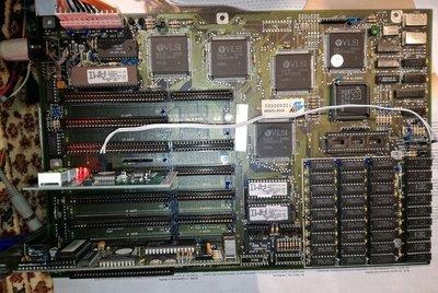

Earlier this month i got this board as part of a lot of 5 defective boards. I've managed to repair 4 of them until now but this one proves to be kind of stubborn.
After neutralising and cleaning the corrosion from the battery i powered up the board, it seemed to work just fine but didn't respond to keyboard input. After some more reboots i noticed that every now and then, like once in five attempts, the board does skip the memory test when pressing the ESC key, and also displays a "Keyboard error" message if i keep any key pressed during a reboot.
But that's just about all it recognizes from keyboard and i've never been able to get past the "CMOS system options not set / checksum failure / display type mismatch / press F1 to continue" screen. It doesn't react to F1 or ctrl-alt-del or any other key.
I have tinned with solder all the traces affected by corrosion and checked multiple times their continuity, including the vias that go through the board and everything checks ok. Also tried with other (known good) AMI keyboard controller, still same results. Even changed the keyboard controller socket, as it was a bit corroded.
As a last resort I swapped the AMI bios and keyboard controller with Phoenix ones from another board with the same VLSI chipset, and in this combination the board hangs with some beeps and code 22 on my POST analyzer, which according to the books 😀 stands for "Test 8742 keyboard controller".
Any ideas / suggestions on what might be causing this kind of behaviour?

Reply 2 of 14, by Predator99
Nice board and nice repair! What tools did you use for this? Looks better than a wire 😉 Did you remove all green corrosion before applying the solder?
How does it look on the bottom side? Are you sure you didnt introduce a short?
Do the keyboards LEDs flash when powering up?
What error message do you get when powering up without a keyboard bios?

@Predator99 - at first i used vinegar to neutralize the spill, then a local isopropyl bath to remove the vinegar. The board was very clean so i didnt have to scrub it entirely with isopropyl. After that i powered it up for the first time, it behaved like described. After that i removed some components (keyboard connector, 2 diodes, 1 resistor, clock crystal and variable capacitor) then i used the tip of a very sharp razor to scrape away from the affected traces all the corrosion/oxidation and remains of the green lacquer (solder resist i think it is called). After that i proceeded to coat all exposed copper with flux then applied solder with my soldering iron. Nothing fancy. I didnt have to use wire because no trace was broken. I dont think i have any shorts, because the board is behaving exactly as it did before my intervention. At a later time i also removed the keyboard controller socket, suspecting there was some damage to the traces below it. There wasn't any, but i fit a new one anyway since it was a bit corroded (and i removed it in tiny pieces 😁 )

Edit: forgot to mention keyboard LEDs behaviour. With the original AMI bios/KBC, the leds blink right after the memory test (i think they should blink immediately after power on). With Phoenix chips, the leds blink at power on and then i get 3-1-3 beeps and code 22 on the display, all of these within a second or so.

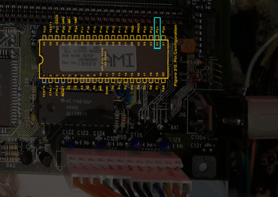

What happens if you pull out enough DRAM to get to 1MB or less and then try booting? (Each of those chips in the photo appear to be 128kB)
Triple-check the connection to this output pin:

The installed ram is 1MB (and that's the maximum, according to stason.org). KBC pin 22 goes to pin 11 of the VL82C102 memory controller (A20 Gate - Used to select the proper value for address bit 20).

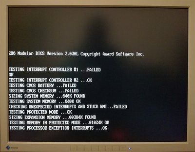

For a quick and dirty test i replaced once again the bios/kbc with some Award ones from (another) working board. This one seems to give the most details about the problem:
193.25 KiB
1370 views
After displaying the above, the system hangs with Code 26 on the POST card. The CMOS battery failed message keeps appearing even when i connect an external battery pack and the RTC chip receives power. I'll keep searching, but after triple-checking all connections from the kbc and all the corroded/repaired traces i'm thinking more and more that the problem lies elsewhere (chipset, support chips).

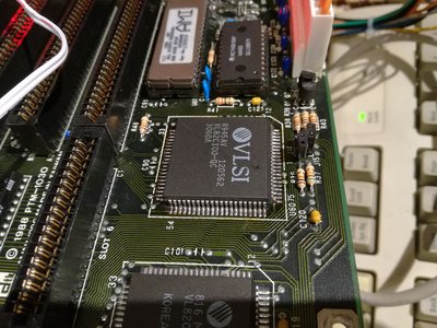

Found the problem, it was inside the VL82C100 peripheral controller. Took my chance and transplanted the chip from another board which had it socketed - it was so tight that i couldn't extract it with the PLCC tool, i only managed to chip away one corner of the package (hence the ugly diagonal scratch). I had to desolder the socket with the chip still in it and then tear it to pieces.
I also tried to solder a PLCC84 SMD socket on the DTK board, to have the chip easily removable in case it didn't solve the problem, but found this to be impossible: the solder pads on the board didn't extend inwards as much as i needed to get a reliable solder joint. Fortunately the problem is now gone so there's no need to remove it again. For the removal of the defective chip i long planned to get a hot air station, but in the end took it off with only soldering iron and copper braid.

391.04 KiB
1262 views
Working!

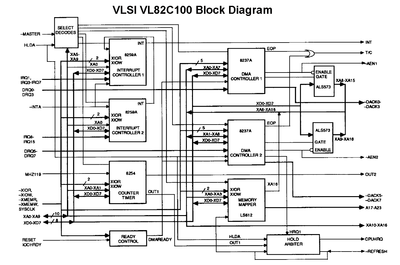

Well, i got myself a new soldering/desoldering station (ZD-917) a couple of weeks ago, and that reignited my interest in my broken boards. I already found a toasted MC14069 hex inverter on this board, but unfortunately after replacing it the board is still as dead as before.
On the DTK board i checked all 14 or so logic chips (desoldered them using the station, tested them in the TL866CS programmer) and all were ok, so i took the risk of exchanging the peripheral controller. I wasn't 100% sure that it is faulty, it was more like a hunch. I must say that the Award bios helped me with that - check that "Interrupt controller #1 failed" message a couple of posts back. And since the interrupt controllers are inside the VL82C100...
