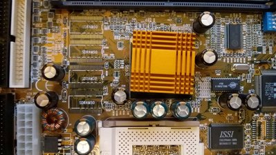

The motherboard is a Gigabyte GA-5SMM.
The manual says it "Supports 512 KB Pipeline Burst Sync. 2nd Level Cache.", a dubious statement that may or may not say that the cache is already fitted on the board. Everything optional is said to be "supported", while on-board things like the audio and video are said to be "integrated".
Promo shots show a board fully populated, but every other amateur picture I find are missing some chips. Here's the terribly blurry shot from Gigabyte:
The four chips right under the golden heatsink (SIS530) are missing:

I have yet to test the board: the initial inspection made me very curious. I don't think I'll send it back because every other shot done by actual users online show them missing, so a fully populated board may be very difficult to find. But I wonder if I am missing something, and if it will affect the performance of the computer?
Reply 1 of 6, by shamino
The board says "SDRAM50" under the missing chips, so those are probably dedicated RAM for integrated graphics. Assuming that's what they are, having them missing shouldn't matter if you're using a PCI graphics card.
Not sure where the L2 cache is, but it might be that chip to the upper right of your photo (between the chipset, DIMM slots, and the blue dip switch). What do the markings on that chip say?
Reply 2 of 6, by dionb
That ISSI chip next to the socket is your L2 cache.
This is a board with SiS 530 chipset with integrated VGA. The 530 could either use UMA (VGA shares system memory) or a dedicated DRAM frame buffer. Performance was far better with the DRAM on board, but of course it added cost. Gigabyte was pretty notorious around 2000 for producing boards with lots of optional features but only including them on demand. The RAM chips you see on the top image but not in the bottom one are DRAM (probably SDRAM) chips. That's what's missing from your board. It will work fine without them, but performance when using the integrated SiS 6306 VGA will be abysmal as opposed to just bad with the frame buffer.

With that solved, yes, I was considering using that integrated video card with a Voodoo 2. Given the very limited space allowed by the µATX format, I was hoping to make the most of the integrated peripherals. I don't suppose I can install these DRAM modules myself? I'm confident I could solder them, but I also see it's missing a bunch of resistors and caps next to it, and I wouldn't know what to add.

Running that on integrated graphics would hopelessly handicap this system. The problem isn't even the VGA performance itself (bad in any event) but the fact that with UMA the VGA shares memory access with the CPU. That means that you lose a significant amount of memory bandwidth, which tended to bottleneck So7 systems at the best of times. The integrated L2 cache on the K6-3+ will compensate that a bit, but my guess is that a K6-2 at the same clock on a board without integrated graphics would run rings around it, so waste of an exceptional CPU in that case.
No experience with soldering DRAM chips in a case like this (my skill is good enough for caps and Raspberry Pi Hats, but SMD is definitely beyond me at the moment), but YMMV I guess, particularly given the other components. Best you could do is try to find a high-res photo of a board with the chips to see what else you're missing exactly. With a bit of luck BIOS would recognise it and make use of it.
That said. I'd recommend a motherboard without integrated graphics as even with the framebuffer installed the SiS 6306 is a snail, and if that's not an option, just disable it and use PCI VGA. Pretty much any PCI S3 or ATi chip should easily beat this thing, even with its framebuffer present and active. Only try to solder the memory if you want that specific challenge.
