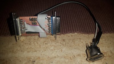

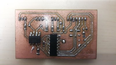

I designed, etched and built a board based on some images from the web.
904.9 KiB
5560 views
It is a Gameport Midi splitter with Gameport through and Schmitt-Trigger Inverter buffer.
Works, but my Midi to USB cable is not working with Munt. It is working with GM though, so maybe it is just too shitty. May need to buy the original Roland one until I finish my UART midi board to directly interface the Pi.

Reply 5 of 57, by mcobit
Tested (well, played through Monkey Island) today and seems to be rock stable with the usb midi interface and softmpu.
I tested a bit with direct uart midi in on the raspberry but it didn't work reliably.
Maybe my raspberry midiboard is not that good. There were problems while etching and I had to repair some tracks.
1.02 MiB
5501 views
Reply 6 of 57, by mcobit
Turns out the board was fine and I was just too stupid and didn't turn off the serial console on ttyAMA0. The different baudrates of Midi and terminal interfered but didn't completely stop it from working intermittendly.
One more thing learned.

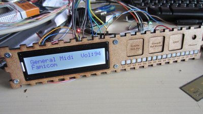

Today I want to program a visualizer for the channels, notes and velocity with some APA102 leds. Let's see how this turns out...
Reply 7 of 57, by mcobit
New Video.
https://youtu.be/gAG-GwYeTpc

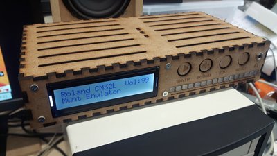

Now with experimental frontpanel and a connection from my P75's SB32 via mpu-401.
I installed a 20x2 lcd now instead of the 16x2. I want to display sysex messages from the munt emulator in the lower row later on and the mt32 had a 20x1 display, too.
The LEDs Indicate the Channels. The louder a note is, the brighter it will flash. Notes are indicated by color. Low: Green, Mid: Red, High: Blue.
Also the volume can be changed with the keys while not in edit mode.

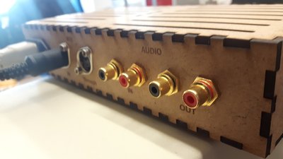

Now I finished the box and put everything inside.
Redesigned the front a bit to accomodate a fourth button for reset and shutdown of the raspberry.
The "fixed" chinese midiinterface seems to do its job. For correct operation I have to restart munt before playing a new game though. But even sysex messages work.

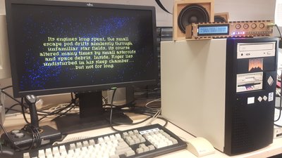

Yes. I also display them in the lower line of the lcd as you can see in the photo with spacequest 3 running.
I did not lower any polyphony settings or alter anything else in fluidsynth and I run on raw alsa hardware device as that is what fluidsynth suggests for best performance.

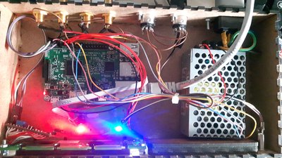

Almost forgot: here is a picture of the inside. With connected lan cable for debugging and also the cable management is not final 😉

What is the power supply you are using?
