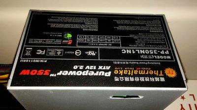

Based on the rail ratings any reason this one won't work with slot 1 motherboards? Intel SE440-BX/2 specifically. See attached pic.

If you will use something like PII with not very powerful Video card it will be good for your needs.
Of course this PSU soes not have the best +5V but is ok for PII and something like Coppermine, but Tualatins will need something that have like 25 amps on +5V.
Also if you want to know what to look for older builds look the amps of the +5V on a PSU as that is the raild that old hardware is using.

Reply 3 of 19, by cyclone3d
firage wrote:
^It would've been next to impossible to find a PSU rated that low (18A) in Pentium I-III times, but it'll probably do.
At the same time, most of the PSUs back then were super crappy quality-wise and were rated way above what they could actually put out because there were no hardware review sites such as Hardocp.com that actually did any type of real power supply testing.
Even the newer cheapo power supplies are rated for way above what they can actually put out without releasing the magic smoke or having good power regulation overall even at lower power loads.

Reply 4 of 19, by gdjacobs
Call it 10-12 amps total 5V rail draw for a basic Tualatin system including the motherboard, and some peripherals. A high performance video card add significant draw, but comparatively little on the 5V rail.
Reply 6 of 19, by buckeye
Well, gave up on the newer Thermaltake and tried the Antec SL350 in my other Win98 rig. Lo and behold, it fired up the 850 P3/SE440-BX2 combo no problem. Below is the rail ratings for the Antec:
+5V - 35A
+12 - 16A
+3.3 - 28A
-5V - 0.5A
-12V - 0.8A
+5VSB - 2.0A
Can anyone tell me which of these enabled the Antec to boot the system where the Thermaltake could not?
Reply 9 of 19, by Ozzuneoj
Based on the ratings, that's a horrible power supply. Thermaltake PSUs have basically always been junk unless you bought something very high end. Don't let the enthusiast styling fool you. Seriously, those rails are pathetic for a 350w rated power supply... I wouldn't be surprised if there were leaky caps and missing safety features in that thing.
Reply 10 of 19, by Tetrium
buckeye wrote:
Well, gave up on the newer Thermaltake and tried the Antec SL350 in my other Win98 rig. Lo and behold, it fired up the 850 P3/SE […]
+5V - 35A
+12 - 16A
+3.3 - 28A
-5V - 0.5A
-12V - 0.8A
+5VSB - 2.0A
Like others have said, it's possible your other PSU is defective. The crossload thingy may also be the culprit.
This Antec has rails that look almost perfect for even an Athlon XP 😁
Personally I've never used PSUs on anything s370 or Slot 1 with less then 25A on the 5v line, unless it had very few parts or some really low-power parts (like a Virge or something 🤣)

Reply 17 of 19, by buckeye

More confusion/frustration! Just a bought a Antec SL400 with the same specs as above except:
+5V - 38A
+12V - 18A
Wont fire up the SE440-BX2/P3 850 config. Psu & gpu fans run but as for the cpu - nothing. Now here's the kicker, hooked up the same psu to my other win98 system (see sig) and it fired up no problem. This is really turning into a "crap shoot". So my solution right now is just swap psu's but would like to know why it's working out like this. Is the Intel SE440-BX2 picky when it comes to power supplies?
Reply 18 of 19, by bjwil1991
Check the capacitors to see if they bulged or spewed electrolytic on the board (or on top of the caps), check for cold or cracked solder points and reflow with fresh solder if needed. My i430TX Socket 7 board does that sometimes as well, but, I'm planning on installing the 24-pin ATX without the -5v to 20-pin ATX with the -5v for certain ISA cards, as well as some chipsets into the system and see what happens. I did test the voltage on the PSU, and it passed with flying colors.
Reply 19 of 19, by cyclone3d
Definitely check the caps on that Antec PSU. I used to use Antec pretty much exclusively until they all started having problems with the caps.
The ones I fixed have not given me any more problems, but I had to run wires in order to use larger sized caps in some of them because of the crappy smaller than normal caps that were used and I was unable to find any good caps that would fit in the original location.
