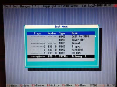

I installed a LSI Logic 53C1010R U160 PCI64 card, along with a 72 GB HDD. HDD ID is 0, set to bootable in Adapter Configuration, all ok. Testing in Linux BootCD and other OS booting from IDE are fine and fast.
Now I installed Win98SE on the SCSI drive, the IDE is disabled in BIOS (Controller set to secondary for CDROM boot, IDE is on primary, so it is OFF).
All fine but it does not boot: Error "E/A Fehler" - I only have a German Win98SE original CD, could be the same as "Disk error"
Boot order in BIOS 1. Floppy, 2. CDROM, 3. SCSI, 4. IDE Harddisk disabled.
With Smart Boot Manager Floppy I can manually choose the FAT32 partition and it boots up very well.
209.24 KiB

The SCSI drive only has one primary filesystem formatted to it?
Is it boot flagged or the active partition?
Does the motherboard bios have separate menus for "boot other device enable" and "boot other device selection" and both are setup?

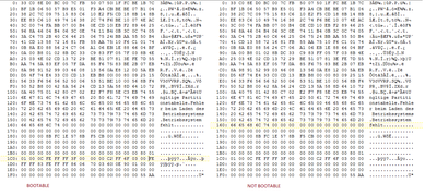

OK guys, so what I've found out is:
- Installations of Win98SE and Win2k on freshly erased drive works both, but does not boot either. Installation of MS-DOS does
- Installation of Win98SE not bootable, installing Win2k afterwards also does not boot
- Installation of Win98SE and SYS A: C: with Win98SE Bootdiskette does fix the boot problem, installation of Win2k afterwards can also boot then. Further hidden Win98SE also Win2k can boot.
So what's the MAGIC with all that? Bootsector of 512 Bytes on EACH PARTITION and a pointer in the bootloader, rather partition table or how is it done? I just want to know, before i spend hours, if i could type in 512 Bytes even with a hex editor manually to fix a problem.
I also used the hex editor for comparison of the MBR between non-bootable Win98SE and bootable. The key Bytes are in 01CF - 01DD which changed in the MBR that is the partition table. So the bootloader was ok. Can't see any changed flags or diff size in parted though!
LEFT BOOTING, RIGHT NOT BOOTING
