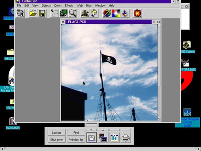

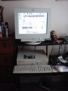

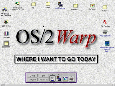

I have a DECpc LPv + 425sx with 16 megs of ram, a 486DX2/66 fitted. It is running OS2 v3 with Warp 4 server network client. It works wonderfully well.
