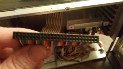

I know it has a 50 pin female cable leading to the display.

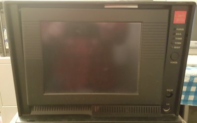

The screen...

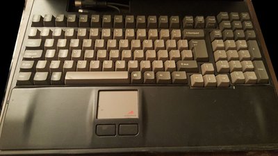

The keyboard...

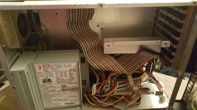

Inside the case...

The 50 pin ribbon cable leading to the display.
