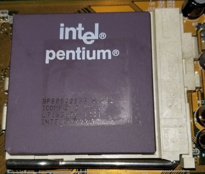

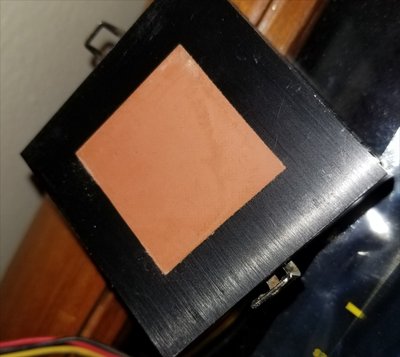

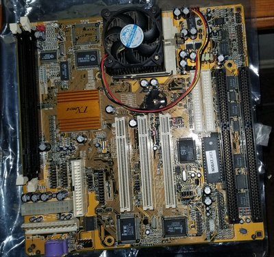

Hi, I just bought this motherboard/CPU/RAM combo off of eBay.
It includes a Pentium 133. I took the heatsink off the CPU and noticed that there is no thermal compound. The copper colored part on the bottom of the heatsink feels like plastic.
The copper colored plastic piece has left a discoloration on the CPU itself.
Should I add thermal compound? Should I try to remove the copper colored thing and add thermal compound? Should I get a new heatsink?
If I need a new heatsink, what is a good heatsink with fan for a Pentium 133?
Thanks.

As long as the thermal pad is intact you don't need additional thermal compound, but I find that pad tends to hard-stick onto the cpu and get ripped off at least partially in most cases, so I just scrape it off completely and use a decent thermal compound instead.
Reply 4 of 8, by dionb
This is a Pentium 133 we're talking about and those things were - by modern standards - very cool parts. TDP was 11.2W, but typical dissipation was closer to 4.3W. You frequently saw them with a heatsink similar to or smaller than the one in these pictures and no thermal compound, pad or other thing to ensure a good fit, but that was good enough.
This pad looks in remarkable order given its age. Yes, scraping it off, cleaning both surfaces first with white spirit, then with meths, then applying a few tiny blobs of good thermal compound will ensure better thermal contact, but will not in any way improve lifespan (it's survived for over two decades like this already...) or even noticeably affect temperatures.

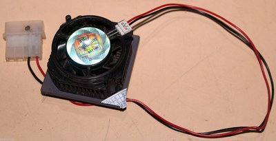

Reply 5 of 8, by Radical Vision
It will be ok like that, as the processors on that era did not heat too much.
That Pentiums have even smaller box coolers, your is 5 times bigger..
