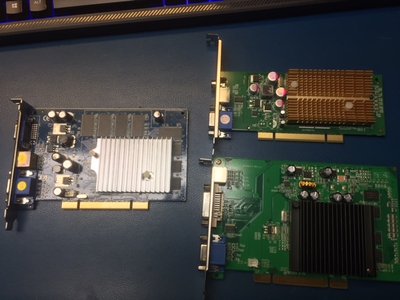

Yo. Building a from scratch NexGen PCI motherboard with PF110 chip.
Ran in to something odd. Yes I know it's probably never meant to run this... Buuuut.
I can get a Nvidia 5200 to post. But I've tried two different Nvidia 6200's and can't get a post.
Does anyone know anything crazy that might help in this build
The two cards that won't work are
EVGA 512-P1-N402-LR
Jaton Video-348PCI-256TV
The one that does work is the;
PNY FX5200 GF05200PUD25G/0TS4AVA
PNY PO # TUV6B13

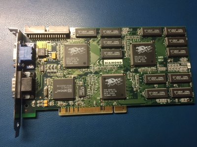

Sorry looks like it's not the voodoo, or is it.....
combo cards of sorts. with a cable. 3 cards not all the same. all with 3dfx chips same length
Diamond 23150109-401 Monster 3D II 3DFX PCI 12MB
    146.69 KiB
    2209 views
Reply 11 of 80, by feipoa
That looks like a Voodoo2 card to me. The Voodoo and Voodoo2 can only run 3D, no 2D. When using a Voodoo1/2, you need to use a secondary graphics card which does 2D. You then connect a VGA pass-through cable from the Voodoo2 to the 2D card. That's why there is the extra VGA port. Your monitor connectos to the 2D card through the Voodoo2's pass-through cable (which is just a short lengh VGA cable).

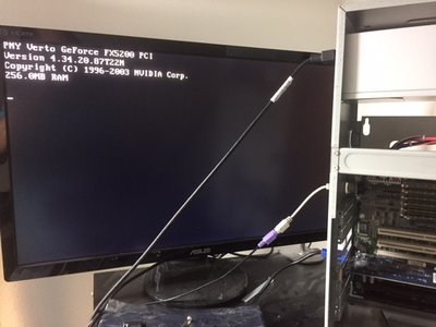

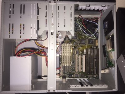

So... I got everything working the best it can. However the inevitable is the problem. It needs full Capacitor replacements. 23-24 years old.
But the project is still coming along.
Bought smaller compact flash cards to play with. Just 256MB. I'll probably use little higher later.
So far the Nvidia FX5200 PCI is the best card I can get to post in it.
Basically just working on this in my spare time.
Reply 15 of 80, by feipoa
