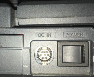

Reply 2 of 7, by arteq
the problem is that the connector looks like on the picture
    372.89 KiB
    1173 views
    8 pin connector

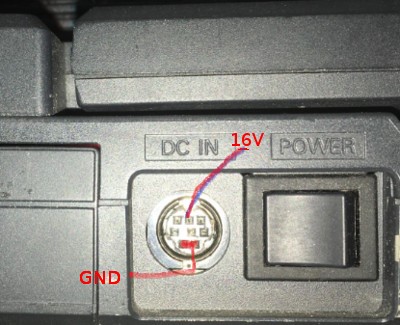

Reply 4 of 7, by matze79
42.75 KiB
1158 views
I have MBC-18NB.
You should replace all Caps inside this Machine.
it suffers from leaking capacitors.
if you don't do this they will eat away circuit traces. Mine already has slight damage.
I'm going to repair it when i find time to make a list of capacitors..
Also the NiCAD accu should be removed.
i open the battery case and removed the cells.
Under the battery is also a small service opening which gives you access to the cmos cell (mitsubishi)
And the Mitsubishi Cell could also leak and destroy the laptop and should be replaced with a new one.
Nice thing on this laptop, no slimline floppy, Gotek can be made to fit inside.
Reply 5 of 7, by arteq
thx for hints 😀
what about other pins ?
I have original PSU but previous owner has cut off original cable ;/
so I an able to reproduce it. So if you can tell me all other ones I would be grateful.
Some items for sale 😀
https://docs.google.com/spreadsheets/d/1YNG8R … dit?usp=sharing
Reply 6 of 7, by matze79
i don't know any other pins.
i have no sanyo psu.
I use a Thinkpad PSU with 16V, and on the Notebook Sticker it says only 16V required.
you may want to open the notebook and look at the dc-dc board,
i'm pretty sure they just connect multiple wires togehter.
on the battery connector are also 16V, seems there is no sort of charge controller..

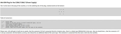

Reply 7 of 7, by arteq
i have sound some info about this laptop.
it's a copy of Commodore-Laptop C286LT
http://tuxmobil.org/c286lte.html
    58.06 KiB
    1082 views
    psu pinout
