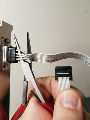

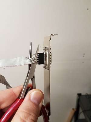

So I discovered something today while trying to get a serial mouse working on my 486.
It would seem that older machines with serial port headers differed from the pentium era and up.
Basically, I thought I was losing my mind when all I was unable to get any serial ports working unless I used add-on serial cards.
I assumed the motherboards had a faulty UARTS ships, but after a 3rd motherboard, I figured something was wrong.
Ok, so here is how its different:
On most pre-Pentium (AT spec?) systems, the ribbon cable is wired as shown.
    153.26 KiB
    362 views
    127.78 KiB
    362 views

I hope this helps some of you to fix/resolder new serial port slot adapters to work on old machines.

Yes, that's good to know - thank you for sharing your discovery with us. 😀
Reply 3 of 4, by Cyberdyne
That i know, but i think there are also porblem with old LPT connectors, because, some old AT motherboards LPT do not work with modern plugs, i tested the grounds and they are the same, only no key, so the standard key is also GND. And last pin, what is also GND, is not GND in those. But all the other pins are mystery. LPT DAC is silent. So something is wrong. And it is problem with those first generation 486 AT integrated motherboards.
