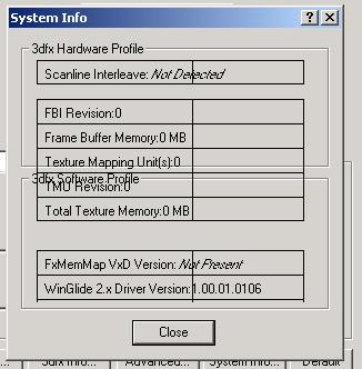

Back at you guys, sorry for only awnsering now. I went with XP.
The motherboard i'm using is a Gigabyte GA-6VXDC7 that i recently recapped with nichicon caps around the power supply area. But this board has been giving some grief mostly because of it's chipset, a VIA Apollo Pro VT82C686 and it's issues\limitations. Firstly the AGP always sets itself to 2X despite being at 4X in the bios. After a quick googlesearch this seems to be a rather well known problem with these chipsets. Also the max ram i can use is 1.5GB, not 2GB.
This would be all fine with me, but now my biggest problem is with the voodoo 2 cards on this board. Unreal or UT for example only run for 4 or 5 seconds before freezing.
Some games like Midtown Madness or a benchmark like 3D Mark won't even recognize the Voodoo2 as it being in the system at all. Also i get this crazy thing on the 3Dfx System info:

The drivers i'm using are the ones at http://www.3dfxzone.it/dir/3dfx/voodoo2/drivers/windowsxp/ which never failed me before...
I'm a bit lost at the moment.

The garbled menu text is probably related to one of the files that the 3dfx drivers try to install. I vaguely remember there being one of those "your existing file is newer than the one being copied, which do you want to keep?" dialog boxes when installing Voodoo 2 drivers in Windows 98SE, and when I chose to keep my existing one it led to that exact problem with the 3dfx info screen. I can't remember the name of the file though. Just taking a quick glance through some Voodoo 2 driver files (for 9x) I have on my system, riched20.dll rings a bell. It seems to be something related to rendering text in certain applications.
As for the crashing, the first step would be to remove a card and test it. If it still crashes, swap cards. If it still crashes, then its less likely to be a bad card (unless they are both bad in the same exact way). It is most likely a driver issue of some kind though. I've never run a 3dfx card under XP personally.

I've tried three Voodoo 2 cards now, all with the same weird symptom. They work fine on other systems.
I'ce ran voodoo2 video cards before under windows xp with no problems, so i'm not sure if this is another motherboard chipset issue or not...
For testing purposes i'm running a Voodoo 3 AGP now on this system and it's running fine.
What gives? :\

Forgive me if this has been stated elsewhere, but was it a fresh installation of Windows XP when you installed the Voodoo 2 drivers? 3dfx cards can be very picky about old Glide or 3dfx related .dll files left over from other devices or driver versions.
Also, check for resource conflicts in the device manager and it might not hurt to reset your BIOS configuration to defaults just in case there are any wonky PCI related settings causing problems.
Almost forgot... what service pack of XP and what version of DirectX is installed?
Reply 18 of 71, by rick6
Hi. Yes, it's a fresh installation and it was the first time i was installing 3Dfx hardware. As for the weird System info it seems to be unrelated as it is mentioned in the readme file that it can happen...
Device manager looks ok, no conflits at all and i already did reset my BIOS, i even tried messing around a bit with IRQ in the bios.
As for the OS it's Windows XP Service Pack2 with DirectX 9.0C.

Reply 19 of 71, by rick6
I think i got it!
Removing the network adatper solved the voodoo 2 crashing in glide games. Beats me why that was the culprit as it's a pretty regular network card. It's a D-link DFE-530-TX. I guess i need to find a replacement for it as i can't live without access to my NAS for all my stuff.
