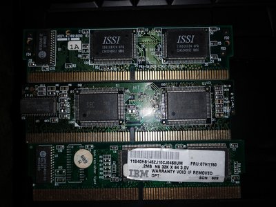

I've found three COAST modules in a big bag of 72pin DIMMS I got recently.
They look functionally similar, and I have a few motherboards with COAST slots, but I can't recall whether there were significant differences in voltage/etc. I need to worry about...

You can use any COAST module.

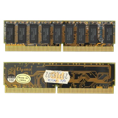

The only exception of which I am aware would be the PCChips M919, which has a very different type of COAST Module, which is actually Static RAM Cache on a stick, rather than Asynchronous Cache (Pipeline Burst). It is not electrically compatible with a normal COAST module.
    637.66 KiB
    903 views
    PCChips M919 Cache Module

Actually, COAST modules are not always interchangeable. Not all are Pipeline Burst Cache and don't expect COAST modules from a Mac to work in a PC. You won't cause any damage trying, however. It either works or not.
btw, that M919 module is a COAST module as well. And according to the M919 manual, later versions of the board (or BIOS, dunno) support Pipeline Burst Cache COAST modules as well.

I do have the M919 manual, board, and pictured COAST module, but although they mention support for a Pipeline Burst module, I'm not aware of any ever being released. In this below linked thread, feipoa has been unable to get and any Pipeline Burst modules functional in an M919. The module also has a warning that it is only for M919.
M919 owners
I would certainly believe that not all modules, M919 aside, are interchangeable.
FIC PT-2003 COAST module supportThis thread provides more information as to the types of issues that can arise.

The manual I have shows an older revision of the board and states that PBC modules are supported in the future. I own the last revision of the board but have not tried a PBC module yet. It's also possible that it would have required a BIOS update. Anyway, the point is that the M919 has a normal COAST slot just like any others. And that backs up the statement that COAST modules are not always interchangeable. 😉

Also for Pentium systems different COAST modules were used. Most notable there are mainboards that use COAST modules with Tag and some without Tag RAM.
e.g. look at this docu for the Shuttle HOT-4515 Layout V2.5 in the section 'Versionen':
http://www.shuttle.eu/_archive/older/de/541.htm
It states 'hierzu ist ein besonderes 256 kB Modul (ohne Tag-RAM) notwendig', which translates to 'here a special 256 kB module (without Tag-RAM) is required'.
