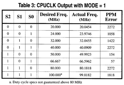

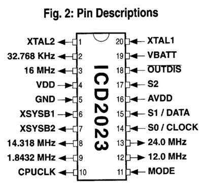

Reply 10 of 21, by lazibayer
Your board has an ICD2023SC-2 chip as the clock generator. It's trickier than most clock generator chips at that time because it can work under "selection" and "programmable" modes, and there is no explicit jumper on your board.
Under selection mode, it functions as regular clock generator and gives a range of bus speed from 20 to 100MHz:
151.66 KiB
1629 views
Under programmable mode things get interesting yet complicated. Please refer to its datasheet for details.
You can probably determine its functioning mode and modifying its frequency output with respect to its pinout.
112.08 KiB
1629 views
Reply 12 of 21, by Skyscraper
To translate to plain english what lazibayer just wrote.
Your motherboard is stuck at the FSB it was set to at the factory (33 MHz) unless you do a complicated hardware mod to switch the clock generator over to "selection" mode or reprogram the thingy that talks to the clock generators serial interface and asks for P121 Q52 because ((2x14.31818)x(121/52))/2 = 33.32 MHz or something like that... totally logical... perhaps I failed with my "translation"... 😀
If you are really lucky there could be a FSB setting in the BIOS as derSammler writes but I think if it's the BIOS who talks to the clock chip that setting isn't accessible to the user. I find it just as likely that there is some little GAL chip or the like pulling the strings.
You can still try the J17 jumper... perhaps the clock generator IS in "selection mode" already but with only two choices avialible... I doubt that jumper can hurt anything anyhow. Or you can just forget about the whole FSB issue as the board is already running at the preferable 33 MHz FSB setting.
And again, make sure that your DX4 is an Overdrive CPU with unboard VRM circuitry before you use it. A normal Intel DX4 could take damage from beeing used on a 5V only motherboard as it's made for 3.3V.
