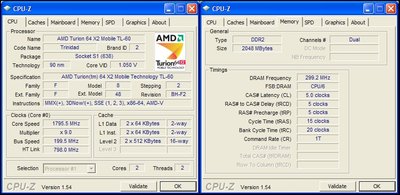

Reply 3 of 16, by Falcosoft
On the Memory tab of CPU-Z you can also see how the memory speed is calculated based on the CPU clock (e.g. CPU/6):

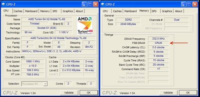

Of course DRAM speed indirectly depends on the FSB speed since the CPU Clock itself depends on the FSB speed. But the DRAM speed directly depends on the CPU speed.
So if you change the multiplier of your CPU the DRAM speed also changes. Here's the 1800 MHz result. As you can see the FSB speed is still the same yet the memory speed is different because of the different multiplier/CPU clock:

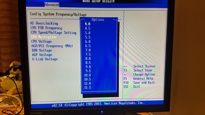

The motherboard is Asus A8V deluxe and it has 0.5x multiplier steps in bios. Latest 1018 bios version.
987.63 KiB
719 views
Edit: CPU speed is still set in bios FSB times multiplier and cpu-z still shows memory speed as 2xFSB. Perhaps it is because I am using old version of cpu-z because newer versions don't work in win98se.

As you can see in that bios picture second option from the top is "CPU FSB frequency" and default value for it is 200Mhz. If I set multiplier to 5.0, the cpu speed is 1000Mhz.
