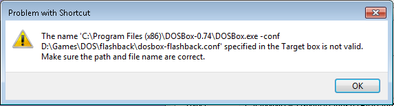

i went to appdata\local\dosbox and copied dosbox-0.74.conf and mapper-0.74.map to the directory where i have my game, D:\Games\DOS\flashback\.
then i renamed them both to dosbox-flashback.conf and mapper-flashback.map and finally i edited my shortcut and used this command:
"C:\Program Files (x86)\DOSBox-0.74\DOSBox.exe -conf D:\Games\DOS\flashback\dosbox-flashback.conf" "D:\Games\DOS\flashback\fb.exe"
but unfortunately windows gives me this message:
9.76 KiB
1028 views
edit: i did it :jots is down: hehe, turns out i had to edit the dosbox-0.74.conf file and in the end of if write my mount commands, thanks a lot!!!
