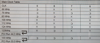

Reply 4 of 4, by karakarga
Specific to Gigabyte 2000 and 2000+ mainboards there are dip switches. At Gigabyte BX2000.pdf, mainboard datasheet page 4 indicates, it is possible to adjust 33.3 MHz instead of 44.3 MHz by making adjustment on jumpers.
Jumpers 5 - 6 - 7 - 8 if off, on, off, off makes 44.3 MHz at 133 MHz bus, but if set to on, on, on, off sets pci bus speed to 33.3 MHz instead of 44.3 MHz. This specialty is specific to Gigabyte, not present on Asus, MSI, others etc. Including that, those two mainboards officially do not have 133 MHz Coppermine CPU support. Maybe, it can be possible to adjust manually....
