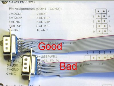

I Just want use ISA or VLB controller because the serial head port uses diffrent pins orders. Its possible use just only disabling the motherboard COM port in the bios? Also using serial PCi card?

Should work - although if and how to disable serial on it depends on the card. Why a PCI serial card though? What's the added value over just using the serial on the multi I/O?

There are two versions, and the solder work is pretty easy.
Upper one is the older and more unocommon, and the lower one is the more common, in use even today.
But the conversion is easy. and you can see the system, one version alternates up and down, and the other just put half pins up and other down.

Thanks for the help. My solder skills are bad. I need some pratice.
