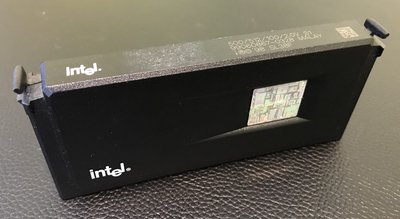

I read on several sites that the Katmai core Pentium III's came in both SECC and SECC2 forms.
I know the Deschutes core Pentium II's received a SECC2 version near the end of their lifespan, but I've never seen a SECC Pentium III ever. Has anyone else, though?

Seems like Pentium III 450MHz SL38E and 500MHz SL38F were SECC. Never knew the existed myself, but I also think it's an OEM part.

Apparently they weren't even original; they flat out reused the Pentium II's cartridge without altering the name of the processor and just slapped the new specs and code on it.

Reply 6 of 8, by Katmai500
I've got one of these. It's an SL38F / 500 MHz version manufactured in week 6 of 1999. They are OEM-only and were never sold as boxed processors.
The general theory I've read is that they were made early in the PIII production run. The early date on mine, and the early date on the SL38F Kamerat posted would agree with that theory, since they were made in February 1999 about two weeks before the Pentium III launch date. The SL38E you posted was made in July of 1999, so that goes against the theory that they were only made early in the production run. Perhaps there was a specific OEM that had certain thermal or packaging requirements that ordered enough quantity to get intel to make special versions.
Intel did at least forgo the Pentium II markings on them.
