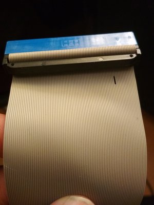

Hello guys,
Today I wanted to test a new pentium 3 build, but I had several filesystem errors during or after windows 98 install. Either a system file is randomly corrupted with garbage or not readable anymore (can't even open those file with any hex editor). I was ready to test the ram and everything else (it's a bit special since it's an SSD plugged with a sata/ide adapter) when I noticed my ide cable had one of the wires cut :
1.27 MiB
1268 views
It looks so clean I can't believe it broke.. My others ide cables doesn't have this. Do you know what is it, an if it could be related to the file corruption problems I have ?

I have some cables like this and was wondering the same thing, but never thought about asking about it.
Only seen this on 80-wire IDE cables, never on 40 wire.

Reply 3 of 10, by PC Hoarder Patrol
No, the hole isn't the cause of any corruption - as Baoran says it allows 40/80 conductor detection at the connector (@GND) and the hole then allows the same conductor to carry any master/slave diagnostic comms traffic. Not all 80-wire cables have the hole, as the same results can be had by omitting the conductor tooth in the connector.

Reply 9 of 10, by okenido
timb.us wrote:
okenido wrote:
I've swapped the SSD several times between my old machine and my modern computer, to do a fast FAT32 format, add various programs and games with simple copy/paste. Is this could be problematic ? (I always turn the machine off before removing/adding the drive)
Did you use proper anti-static handling protocols when doing so? You could have zapped something on the SSD. I’d try using Parted Magic (or similar) to put the drive in diagnostic mode and see what it says.
I just touch a ground wire before when I don't forget. It's a Samsung SSD which doesn't have any pcb that could get in contact with hands so it's probably not that.
Looking closely at the sata/ide adapter, there were something between two legs of the chip, it's so small I couldn't see what it was, but I cleaned up the whole thing with a toothbrush and white gas (it had a bit of dirtyness despite it's new, like badly cleaned up soldering flux), and I didn't got any corruption after multiple reboots, file manipulations and disk swapping. I need to test more to confirm the problem is really gone though...
