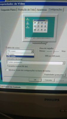

The 256-color limitation is probably due to missing drivers. 256 colors was normal for 3.11, 16-bit for Win9x (desktop).

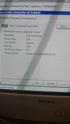

Without a driver, neither Win3.11 nor Win95 will display more than 16 colors. Because they revert to standard VGA, which can't even do 256 colors in 640x480. (Win95 actually allowed to still select 8-bit and 16-bit, but would fail to actually use those modes)
Reply 4 of 22, by firage
An Am5x86 based 486 should have a full megabyte of video memory, 2MB not unlikely. With the correct driver for the configuration, you should get 16-bit color at 800x600 with 1 MB or up to 1152x864 with 2 MB.

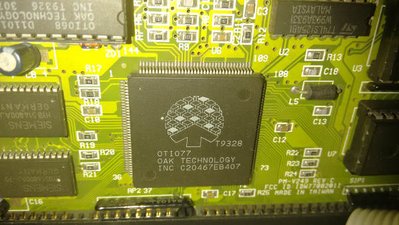

Welcome to VOGONS!
To allow us to fully help you, please post a picture of your video card. If it's integrated into the motherboard, please post a picture of that.

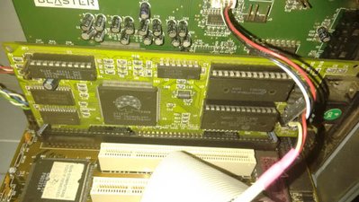

Thanks, the forum is great. I did a lot of search about old PCs and google always ended up sending me here, so I decide to participate.
The video Card is OAK with 1 MB and ISA 8-bits slot.

Windows 95 says it have 1MB memory:

But I dont have more than 256 colors option:
