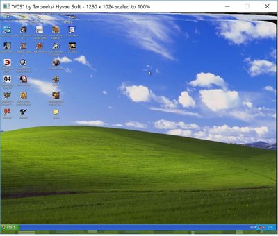

Reply 14 of 183, by Muppets4
I've received and installed my Datapath DGC103 PCI capture card. Downloaded the latest drivers from their site and manually installed them on Windows 10 x64. Started OBS to see that the drivers work correctly. And they do. The image that I get is good, but not great. It's way to soft for my likes.
I just installed your program. I'm experiencing some problems, which I hope to sort out, because the image appears to be miles ahead!
- I sometimes have to re-open the program a view times before I can see what's on the screen. What I see reminds me of my old CRT monitor set at a too high refreshrate
- the 1024x768 resolution looks great, the 1280x1024 has problems on the top and bottom of the screen
298.92 KiB
8081 views
- I cannot use the mouse and/or keyboard (in OBS they work fine). Nothing seems to happen
- o, and something I feel stupid about..... how do I record video?
Is there anything I can provide?
Reply 15 of 183, by vvbee
I've seen certain issues at high resolutions i.e. 1024 x 768 and above but haven't looked into them too much. For instance if the source is 1024 x 768 and the capture card doesn't initialize it correctly on startup, the screen may appear frozen. This has been an issue with datapath's own viewer as well. Simply forcing the correct input resolution should solve it. As for capturing 1280 x 1024 full-size, it's unclear whether you can with the visionrgb-pro. Datapath's own viewer doesn't let you output at that resolution and doesn't say why. It works if you apply hardware downscaling first but vcs doesn't implement this (always asks the card to submit frames full-size).
For recording you'd use a screen recorder over the window.

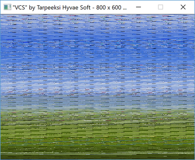

Reply 17 of 183, by Muppets4
937.3 KiB
8061 views
In 800x600 I get a scrambled screen in VCS. Both input and output report the correct resolution. OBS has no problems showing this, but still a soft (allthough lesser then on the higher resolutions) image.
edit: when I boot up the captered PC while still using VCS, it shows the bios and startup screens just fine. When it enters Windows XP it's like this
Reply 18 of 183, by vvbee
Hard to say. Possibly you won't be able to use vcs with that combination of hardware and/or software. The only thing that comes to mind is you may not have the correct 32-bit rgbeasy dll if you fudged them in manually.
