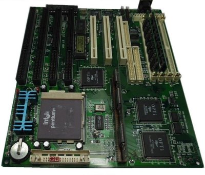

Does your motherboard look anything like this?
158.23 KiB
1131 views
But really, a photo of what you actually have would help a lot. And why are you trying to take off the CPU - does the computer not work?

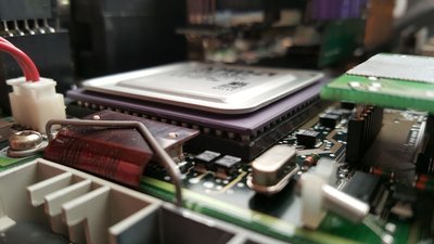

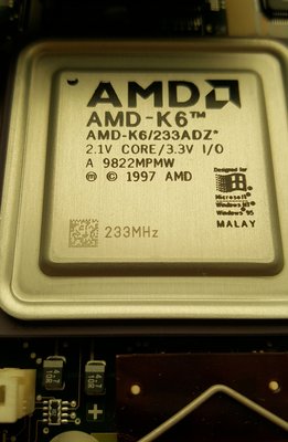

Reply 10 of 13, by user33331
Ok. Here I disassembled the PC again.
I was at work so that is why unable to send photos earlier.
    243.12 KiB
    1088 views
    92.45 KiB
    1088 views

Reply 13 of 13, by Malvineous
