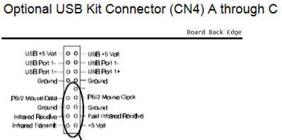

Originally those boards had optional custom PS/2, USB and IrDA bracket for 2 rows of pins between PCI slots (CN4). Are they pin compatible with normal brackets and if so, which pins are for USB and PS/2? I assume first pins from left to right are for USB, but not 100% sure.
Reply 1 of 4, by PC Hoarder Patrol
According to the online manual (for a 5AGM3) the 8 pins nearest the board edge are for USB and the remaining pins are split between IR and PS/2 mouse; like this
    24.89 KiB
    514 views
Reply 2 of 4, by The Serpent Rider
Looks like PS/2 is not compatible with normal brackets.
Reply 3 of 4, by PC Hoarder Patrol
Could you not re-jig the pins on a standard bracket header (assuming you're not wanting IR functions) or as an alternative, use something like the Startech USBPS2PLATE off of one of the USB headers?
Reply 4 of 4, by The Serpent Rider
I'll just use USB mouse, there's legacy support option anyway.
