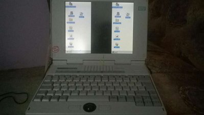

I have an option to buy Siemens-Nixdorf laptop for a reasonable price... but the screen is broken, displaying the same thing twice, as you can see below. What do you think might be the reason and how difficult it could be to repair?
    32.72 KiB
    571 views
Reply 1 of 7, by Jo22
Hi, what happens if you do attach an external VGA monitor ? Same issue ?

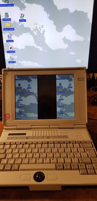

Reply 4 of 7, by OldCat
No, image is fine. See photo below.

Reply 6 of 7, by Jo22
OldCat wrote:
Ah, okey dokey. So the VGA is alright, that's good! 😀 I suspect that there's a bad connection on LCD panel then.

Reply 7 of 7, by OldCat
The original Gameboy had screen issues, which resulted in a "similar" effect (missing lines, dead spots, etc).
See https://youtu.be/l4PArFarm_k
I dismantled the monitor, checked LCD (it's NEC) and connectors, but I am not good enough in electronics to fix if there are problems with LCD itself. Found another S-N laptop, bought it, will try to make a hybrid that works.
