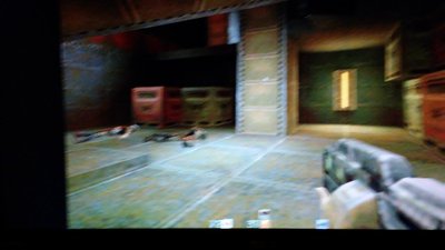

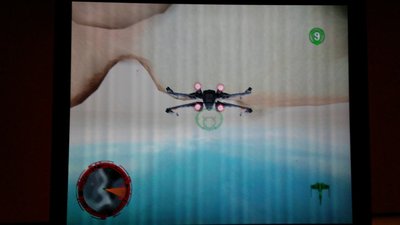

Reply 4 of 12, by buckeye
I attached some pics showing the "vertical overlay" I'm seeing with my V2's. During testing I've found out both cards have the problem in the (2) games I tried in glide mode:
Incoming - each card alone shows it along with SLI mode regardless of high/low graphic settings.
Rogue Squadron - SLI shows it in 1024 x 768 but not in 800 x 600
Each card by themselves show it in 640 x 480 but not in 800 x 600 (weird)
Tried turning off V-sync and ramping up monitor refresh rate to 75 to no avail. Don't know of anything else to try besides uninstalling the latest ref. drivers and trying the others.
On that note which drivers should I try next? The originals, Fast Voodoo and all it's iterations?

Reply 7 of 12, by F2bnp
Try using a direct cable to the card just to check if it is the passthrough cable. However, this seems more likely to be a scaling thing with the monitor to me. Is there an auto adjust feature on the monitor's options? If so, try giving it a go when in-game.

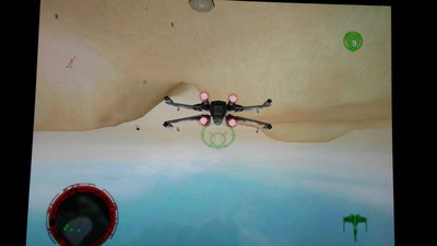

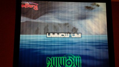

Reply 10 of 12, by buckeye
Hooyah!!! you hit the nail on the head man! Ditched the pass through cable and connected to my Asus monitor via separate vga/dvi hookups, sli works great no lines! Thank you!!!
