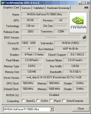

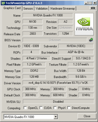

Intro
About a week ago, while rummaging through Marktplaats, I spotted a Quadro FX 1000 which had been mislabeled as Geforce 5200. I always wanted either this one or the Quadro FX 2000 since they are based on the NV30 chip, the same one powering the infamous dustbuster. I went ahead and bought it for €7 + shipping—good deal. Upon arrival I inspected it and realized the memory chips used in this card are actually the same ones used in the 5800 Ultra! (I couldn't find the exact datasheet for these markings, but they are the same that can be seen in pictures from reviews of the 5800u.)
1.23 MiB
9047 views
15.37 KiB
9134 views
So, while heavily underclocked at 300 Core / 300 Mem, the card will for sure reach a memory frequency of 500 MHz... if I can overclock the core to 500 MHz I'll have something special in my hands 😀 I started fiddling around, overclocking only the core, and when I pumped 1.5V into it it would do 500MHz easily, if a bit hot. And thus, the idea sprouted: lets mod the BIOS and turn this into a GeForce 5800 Ultra!
Why do this?
  • because is neigh impossible to find a “real” 5800u,
  • because when you find a “real” 5800u, you have to choose between buying it and paying rent,
  • because you enjoy tinkering with hardware,
  • because you want a quieter, single slot 5800u,
  • because you can!

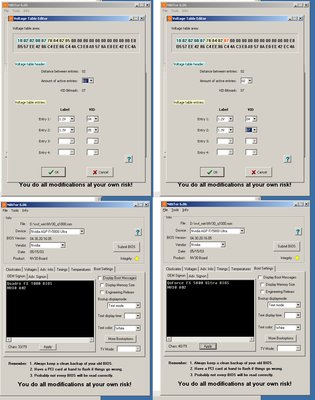

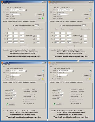

This part is done in NiBiTor. I opened up my backup of the BIOS and looked around, decided to change the following parts;
  • I added a second performance level, to differentiate 2D from 3D. Set the 3D at 500 / 500
  • Changed the Device ID and Sub System ID to a GeForce FX 5800 Ultra (changing the Sub System ID is not necessary, I did it to match a 5800U bios I found online)
  • In the Voltage table editor there were, curiously, 2 active entries. I say curiously because the BIOS was configured for 3D only, so I have no clue when it would use the 1st voltage entry. I just changed the VID of the 2nd entry to 7 instead of 5, this will give the card 1.5 V instead of 1.3 V when it goes into 3D mode.
  • Changed the bootup message to display QuForce FX 5800 Ultra 🤣
308.63 KiB
9134 views
311.25 KiB
9134 views
With all those changes made, I saved the ROM as NV30_qf5800u.rom and flashed it. Since I have no other nvidia card in my system I didn't bother setting the index parameter,

All good, its done! Uninstall drivers, reboot, reinstall drivers…
15.48 KiB
9134 views
So, after all this I have the original BIOS and a strapped BIOS, which will allow me to change the identity of the card with a single command and a reboot. Later I'll describe the necessary cooling mods to keep it at a manageable temperature when running in 3D.

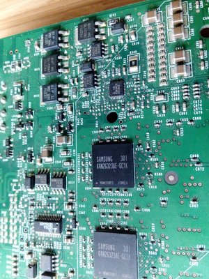

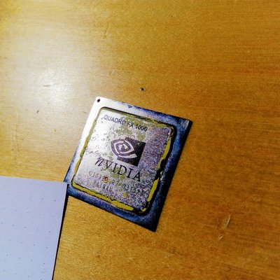

Reply 4 of 147, by slivercr
Tetrium wrote:
Any pics of your legend? 😁
Just a teaser for now, I dare not show it in its current ugly state 🙁
1.48 MiB
9107 views
I have my sights on a cooler in Marktplaats but the seller is not responding 😒

New Strap0-AND (HEX) : 7F DF FF FF
=>Straps to flash 0x7FDFFFFF 0x00000000 0x00000000 0x80000010
So, download the BIOS I attach here and get ready to flash: have a backup plan! PCI video card, rescue floppy, something. The commands I give will not permanently damage the card, but may render it unusable if I messed something up or if something happens during flashing. You will need to reflash your original BIOS if something happens. That said, the commands you must run are
nvflash -j -5 nv30_qf5900.rom
nvflash --straps 0x7FDFFFFF 0x00000000 0x00000000 0x00000010
Let me know how it goes.

Reply 12 of 147, by slivercr
The straps are embedded in the BIOS. You can just flash back your original Quadro BIOS with
nvflash -j -5 original.rom
and it will work immediately, without need to adjust the straps. Same for the strapped BIOS, if you are returning from Quadro to strapped you just
nvflash -j -5 strapped.rom
and it will also work immediately, since the straps are already adjusted.
So the problem we solved is: if you change the DeviceID in the BIOS, with NiBiTor for example, it doesn't automatically change the straps. So if you flash a new BIOS that says Geforce FX 5900 Ultra, but the resistors in your hardware say Quadro FX 3000, you're gonna have a bad time. Adjusting the straps means we read the values given by the resistors—the hardware strap—, disregard them, and set them to what we need with the BIOS straps 😀
EDIT FOR CLARITY: There are 3 levels of straps: Primary (Hardware level, resistors on the PCB), Select (Strap0-AND and Strap1-AND), and Secondary (Strap0-OR and Strap1-OR). To change the ID in the card you have to change 2 things: the DeviceID in the BIOS, and the Straps related to the DeviceID. The straps can be changed either in hardware (moving resistors around), or in software (adjusting the BIOS like we did). If you flash a BIOS with a DeviceID different to the one indicated by the Straps, the card will not work properly (usually no video upon reboot).
So, the 2 step process I had you go through was:
-flash a BIOS with a different DeviceID, this change will not change the Strap values in any way. If you stop here, you will get no video upon reboot.
-flash new strap values for the new DeviceID into the BIOS, this is equivalent to moving the resistors on the PCB. The strap values are embedded into this BIOS and will not need to be adjusted again, they are just meant to bypass the hardware straps
Now you have your original, unmodified Quadro BIOS, and a strapped Geforce BIOS. You can flash either at will and they will work immediately with your card, without need to adjust any straps ever again.

Reply 14 of 147, by meljor
Don't forget to cool the ram. I have the normal fx5800 (400/400 clocks) and that one even has big heatsinks on the ram and a dual slot cooler. I also have the fx1000 and when i clocked it at the same 400/400 as the fx5800 it was identical in 3dmark scores.
Also have the other cards in this series and the fx3000 is also exactly the same speed as the fx5900 when i tested it (at least within the margin of error).
You are absolutely right about the RAM cooling: its actually the one thing I have to figure out how to do better. Right now I have some mismatched aluminum blocks fixed with thermal tape—the reason I don't want to showcase the card just yet 😅 I would like something beefier because they get hot! I'm looking around for heatsinks that I can actually mount using the mounting holes already in the card, but I can't seem to find any.
At the same time, I would also like to keep it in my dual Tualatin system, but the spacing between the RDRAM and the AGP slot is very tight, so big RAM heatsinks would make the card not fit. Also, hot RDRAM next to hot video card doesn't sound too wise.
Decisions, decisions.

Reply 17 of 147, by RogueTrip2012
You are absolutely right about the RAM cooling: its actually the one thing I have to figure out how to do better. Right now I ha […]
I'd say toss a 120mm fan in the area to cool the ram and video card. Cheap and easy since you already have heatsinks on the ram
Dunno if applies to WinXP but in Win98SE I've found a few things using certain drivers versions
With the acclaimed 45.23's you might see Ram is reported in DirectX as 128MB for the video card in 3Dmark, Everest, and DirectX control panel (someone reported for them 256MB started getting reported correctly around driver 52.70). Also my FX3000 idles around 33c and hardly goes up from there. Lastly Rivatuner 2.24 Enables 2xAA in the drivers even though its application controlled in the NV control panel.
Using the 56.64's I do see ram reported as 256MB on my FX card. Temps go up to about 44c idle though and saw about 48c later on.
The thing is, the RAM cooling I have now requires me to replace 2 RDRAM sticks with CRIMMs, otherwise it will not fit. This reduces my RAM from 2GB to 1GB, which would be ok for a 98se only system, but I run Linux and XP, which can for sure use the extra memory.

Reply 19 of 147, by havli
Great work modding the Quadro! 😀
Regarding the memory cooling - I'm lucky owner of the "real" 5800 Ultra 🤣 and the GDDR2 are running very hot on my card, especially modules on the back side. The rear heatsink is too hot to touch, which means 60+ °C. Maybe Quadro is running lower voltage or using slightly different kind of DDR2... but still I recommend to keep an eye on the temperature.
