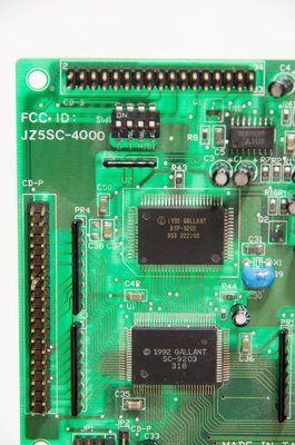

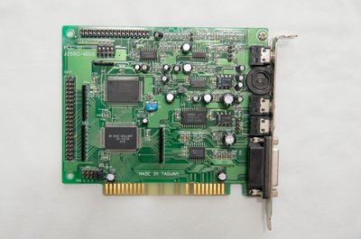

Here is a card that I received today with a lot of other cards.
I am unable to find any information on this card except that is was made by Viacon:
https://fccid.io/JZ5SC-4000
It does have OPL2, and adjustment for IRQ and which CD-ROM interface to use as well as switch labeled G I MIDI.
It also looks like you can route the PC Speaker in as well as maybe sound out to the PC Speaker.
Apparently Goldstar made a 16-bit card that uses the same main chips but not finding the drivers for that card either.
1.58 MiB
220 views
1.85 MiB
220 views
Edit: Is it the Gallant SC-4000?
If so, the drivers are on vogonsdrivers:
http://vogonsdrivers.com/getfile.php?fileid=5 … &menustate=35,0

Reply 1 of 1, by matze79
Doey it really need drivers ? looks like you simply set IRQ and Adress with DIP Switch.
and just SET BLASTER=mysettings...
