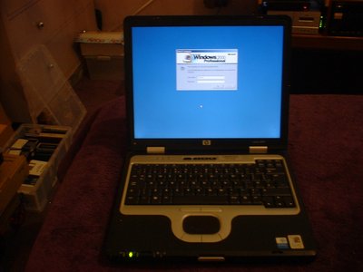

I have a working HP nc6000 which orginally had windows 2000 factory fitted ..
Sadly the hard drive died long before I got it.
Easy enough to fit a replacement ..but of course I do not have a recovery partition.
I have no recovery discs ..so what to do ?
All I have is the product key sticker underneath.
Of course ..HP would no longer be interested ..or able to help.
But recovery discs must have once existed ..not that I can find them anywhere.
But maybe someone on the group has these discs.
I'd love to restore this laptop to it's former glory but can see no way to do this.
Can anyone help ?
Afterall ..it's what we do as lovers of retro hardware.

STX wrote:
You can probably get by with this ISO:
https://archive.org/details/Microsoft_Windows … _Microsoft_1999
You won't get any pre-installed applications though, but that's probably a good thing.
Cheers STX ..
I'll grab a copy and give it a go.
rgds
VS
Reply 3 of 3, by Vipersan
Finally got a win2k rebuild I'm happy with ..although couldn't use the key from the label on the laptop..
There were 2 sets of audio drivers for this unit ..but the Soundmax drivers did the trick ..
Conexant was a no go.
The real problem lay with video drivers ..
Tried several listed as for XP or 2000 from HPs site ..
none worked and only resulted in a BSOD with no way back ..
I had to rebuild the OS at least half a dozen times between tries ..but eventually found a much older ATI install (SP27665.exe) that works, using a very general search on the net.
So ..now I have a working NC6000 laptop with Win2Ksp4 for my collection
