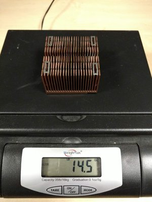

Reply 7 of 16, by lazibayer
tpowell.ca wrote:
Anyone have a good recommendation for a great passive cooler that could handle even a K6-III+ ?
Are you overclocking? If not, is your board able to supply lower voltages such as 1.6v or 1.7v? If yes, you can try and see if your CPU can work at such low voltages. In this scenario a decent S370 heatsink with good air circulation will suffice.
If you have to run the CPU at stock frequency at 2.0v or above, the next question is: is your board vertically or horizontally mounted? The socket and the board in that era ain't designed to hold heavy beefy heatsinks. They will eventually warp or even break after long time use. If your board is horizontally mounted, you can use copper S462 heatsink that fits your board and strengthen the socket with supports underneath the board. I used this heatsink for my horizontal K6-3+ build. I came across it on ebay but unfortunately I don't know its model.
100.61 KiB
854 views
In other cases, you might have to stick with air cooling or upgrade to water cooling.
