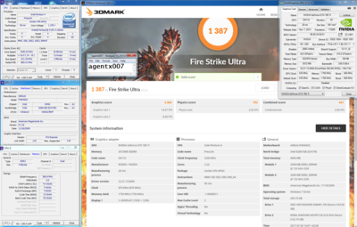

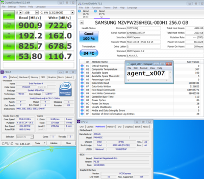

Reply 8 of 9, by agent_x007
Most surprising benchmark...
367.64 KiB
620 views
I would say 900MB/s read and 720MB/s writes for any hard/solidstate drive on PGA 478 won as my most suprising one 😎
Here's GPU benchmark for this setup :
702.38 KiB
613 views
I switched NVMe drive with GPU (since board only has one x16 slot).
However, Native Hex Booting from DOS on CF, up to Windows Server 2016 on NVMe drive within single system wasn't far behind (it lost, due to not exactly something that can be called "benchmarking" and being more ridiculous or "Mad" to Me) : LINK 😉
